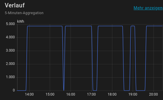

The masking from the heatpump states works, looks like this:

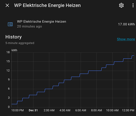

        "name":"Elektrische Energie Heizen",
        "state":
            "{%- if states('sensor.wh_warmepumpe_betrieb') == 'heatpump_operationmode_heating' %}\n        {{ states('sensor.wh_statistik_elektr_energie_jahr') }}\n      {%- else %}\n        {{ 0 }}\n      {%- endif %}","state_class":"total","template_type":"sensor","unit_of_measurement":"kWh"

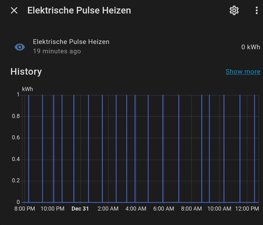

Thank you very much. Option number 1 lead to the solution I had in mind. I did the following:
  1. Created one template sensor for each operation mode of the heat pump I wanted to track the electric consumption (Heating, water, defrost, everything else)
  2. Trigger them by the increase of the yearly electric power consumption register
  3. Determine the current operation state and create assign the increase (to_state - from_state) to the corresponding sensor. Or to be more specific: only assign value if operation mode matches, 0 otherwise.
  4. Trigger them every minute an reset the value to 0.
This will create 4 Sensors which create a spike (usually of value 1) each time 1 kWh in consumed in the corresponding mode. This looks like this:
Now, I can create a Utility Meter for each sensor and configure it as “Delta Value”. This meter will then increase on every pulse and show the total consumption of electrical power for the corresponding operation mode.
I also included to ignore a negative slope on the template sensor. This will filter the reset of the electrical meter on first of January:
