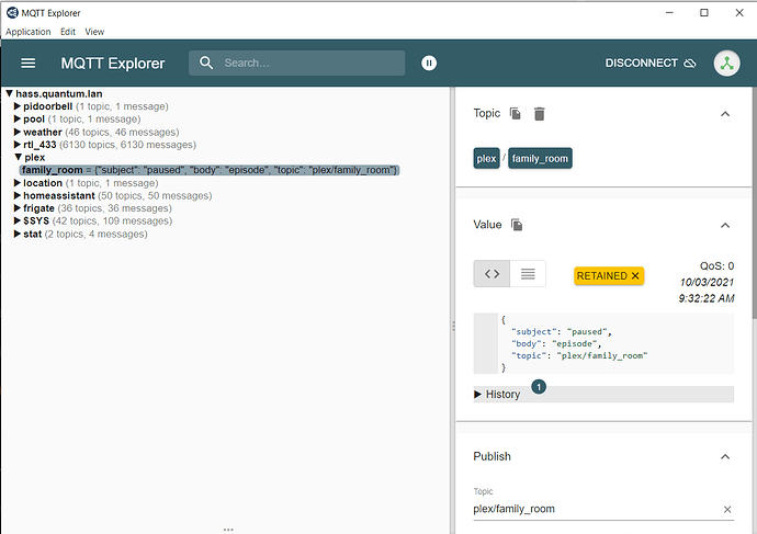

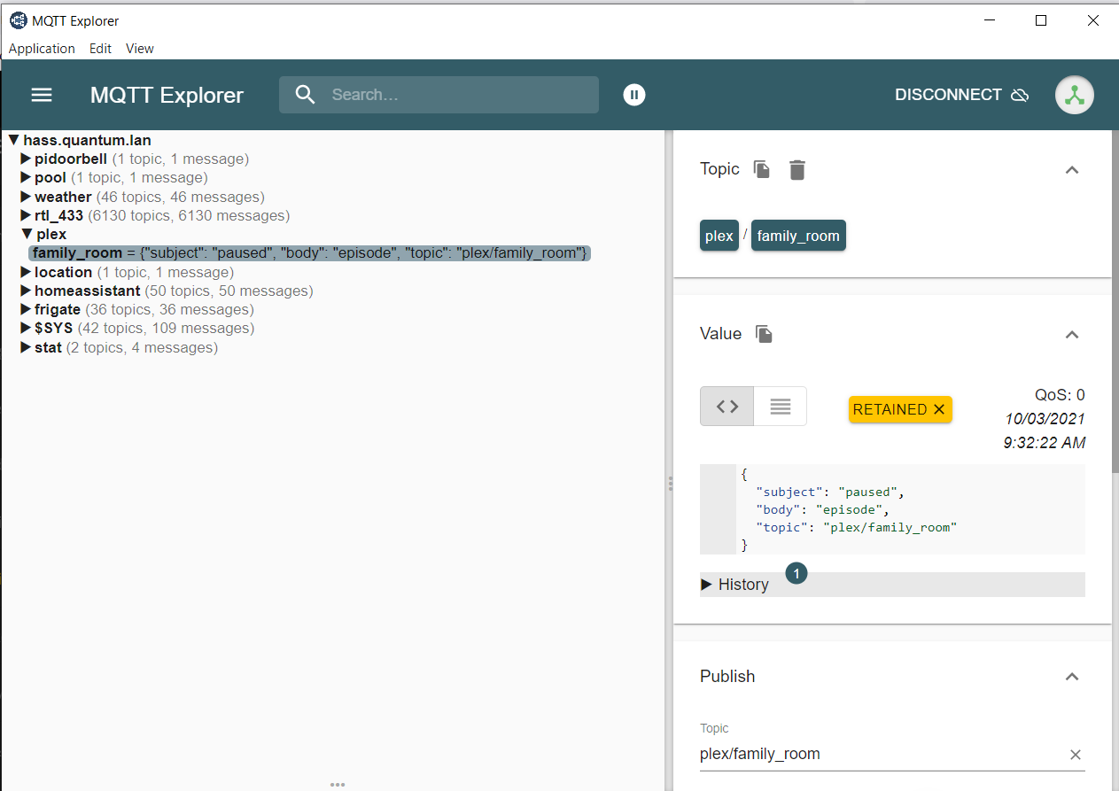

What do I put under «Topic» in tautulli mqqt settings?
It can be what ever you want, you will just need to match this name with your sensors. I use plex/family_room and it shows up in MQTT like so:
