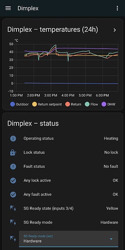

Here it is - as a bonus from me, you get undocumented register 114 which is reflecting the inverter frequency in Hz (indirectly representing the load on the pump, as I do not have the heat meter built in the pump).
The sensors, coils and registers are nicely grouped, some templates I asked for mapping numeric states into labels, and some work around smart grid features (alas the smart grid setting for mode red / yellow / green / deep green in my case does not work, I have it wired in hardware to tado controller). In my setup, with LAK9 being pretty old Dimplex heat pump, not everything gives proper reports, in newer models more data might be available. There are some leftovers left, mostly around registers available for setting, I might drop them in later.
There’s a dashboard also with sample use (status board, temperature an inverter graphs)

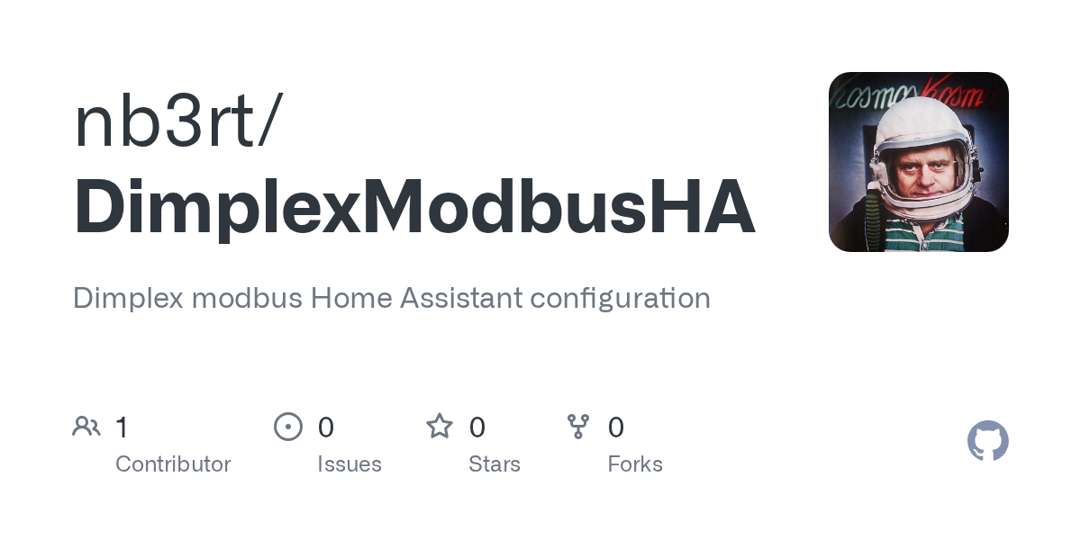

Thanks for sharing your project. I used it to connect my own dimplex heatpump to home assistant. I forked your repo and adapted the config to my needs. You can find it here: GitHub - steiny2k/DimplexModbusHA: Dimplex modbus Home Assistant configuration · GitHub
Important to mention is there is a Modbus and a Modbus Extended configuration in the menu. They have significantly different register addresses. It seems the Modbus TCP module uses the addresses of the Modbus RTU interface card with "Extended" setting. One can get these Modbus RTU cards Carel or Dimplex through AliExpress for quite cheap (50 EUR). Just search for PCOS004850. And connect them to a Modbus interface card such as the Elfin EE11 which I used.
