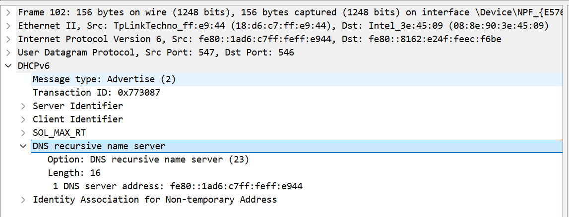

Thanks for confirming this. I have now sniffed the packets and it seems it’s my openWRT access point (running on a TP-Link device with disabled routing) sending IPv6 DHCP offers with (for reasons yet unknown to me) the HA server as the DNS server.

Anyway, found the culprit setting. Under Network → Interfaces → edit the LAN adapter → DHCP Server → IPv6 settings → set both RA-service and DHCPv6-Service from the default “hybrid mode” to “relay mode”.
As I just learned, in hybrid mode it will play authoritative DHCPv6 server automatically, if there isn’t an other one in the network.
