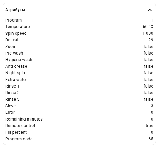

Thank you all, this is what I’ve got

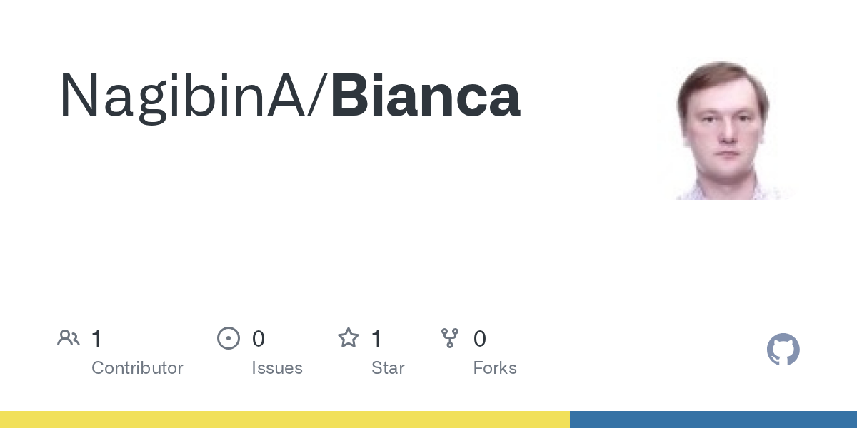

Fantastic!! You can learn me to created the same configuration? I have candy bianca

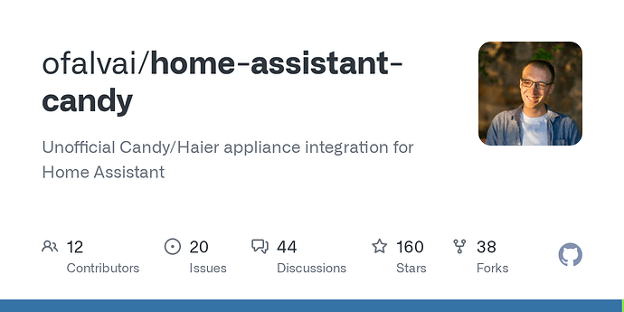

Hi, I ran into this issue last year, it actually broke my EXISTING working machine for a while.
Luckily it came back online for me at some point, and as soon as it did I firewalled it from having internet access at all.
I now use mine entirely with the local API, using a combination of methods others have described above.
Using yaml to get sensors for status sensors. And a fixed command which I encrypt and send to the machine to make it run each night from a separate Pi, using a webhook command from Home Assistant.
Hope this helps you get a direction to get it working without having to rip out the ESP. But if you do end up doing that I’d also be interested to see if you manage to make something better :slight_smile:
you can customize it for yourself, I don't use encryption, and the only integration is the Candy Bianca washing machine
