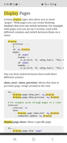

Theres a whole section in the Display documentation that specifically goes over this and gives you multiple examples…

These didn’t work?
display:
  - platform: ...
    pages:
      - id: page1
        lambda: |-
          it.print(0, 10, id(my_font), "This is page 1!");
      - id: page2
        lambda: |-
          it.print(0, 10, id(my_font), "This is page 2!");
on_...:
  - display.page.show_next: my_display
  - display.page.show_previous: my_display
Please tell me which one. If possible with an example. I have a large delay on the screen of the picture on the screen.
