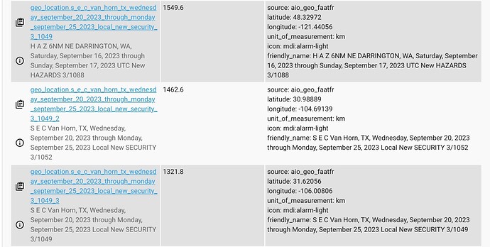

I’m not sure if this will help you or not. A while back, I wanted to map a series of ‘events’ on the Home Assistant Map element from a GeoJSON feed. I am using a subset of the code in the link below. I did not implement the complete code in this repository as it was pretty complex within HA’s custom components function and the HA Map element still seemed to only show a rather strange subset of the data in the GeoJSON feed. I came up with a pretty hillbilly tech hack to set the first three characters of the ‘friendly_name’ to be something somewhat useful. As you have seen, the map displays the first letter of the first three words in the ‘friendly_name’, strange implementation IMHO. If you float over an entity on the Map element you can full ‘friendly_name’ that is generated by the geoJSON entity however. I too hope the referenced PR to improve the Map element moves forward. Or if you are adventurous, the code below might give you some options. Good hunting!
