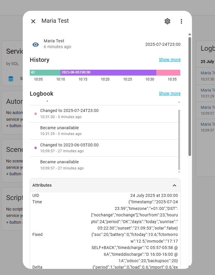

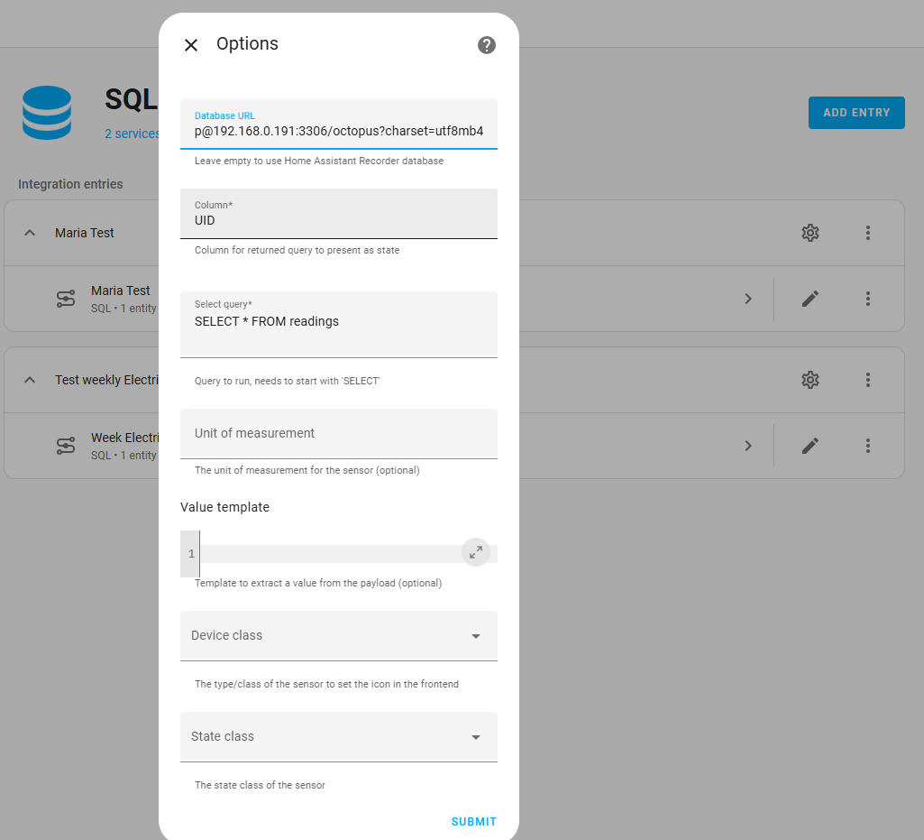

OK so I used the UI for the SQL integration - much easier than messing with YAML.
OK so I have a separate machine with my separate Maria DB on it.
Took about 5 minutes to get working tops.
Database_url: mysql://user:password@192.168.0.191:3306/octopus?charset=utf8mb4
Query: SELECT * FROM readings ORDER BY uid DESC
Column: UID
Where -
  • user is the username of the Maria DB install
  • and the password
  • 192.168.0.191 is the ip address of the machine used
  • 3306 is the port on which Maria is exposed
  • octopus is the name of the database I am using in Maria
  • ‘readings’ is the name of the table in the database
  • ‘UID’ is one of the columns in the table
The simple query returns ALL records (sorted in descending order) and the SQL picks just the first one, with the named column value in entity state, and the rest of the columns in attributes.

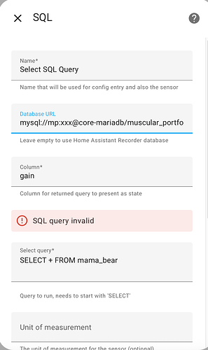

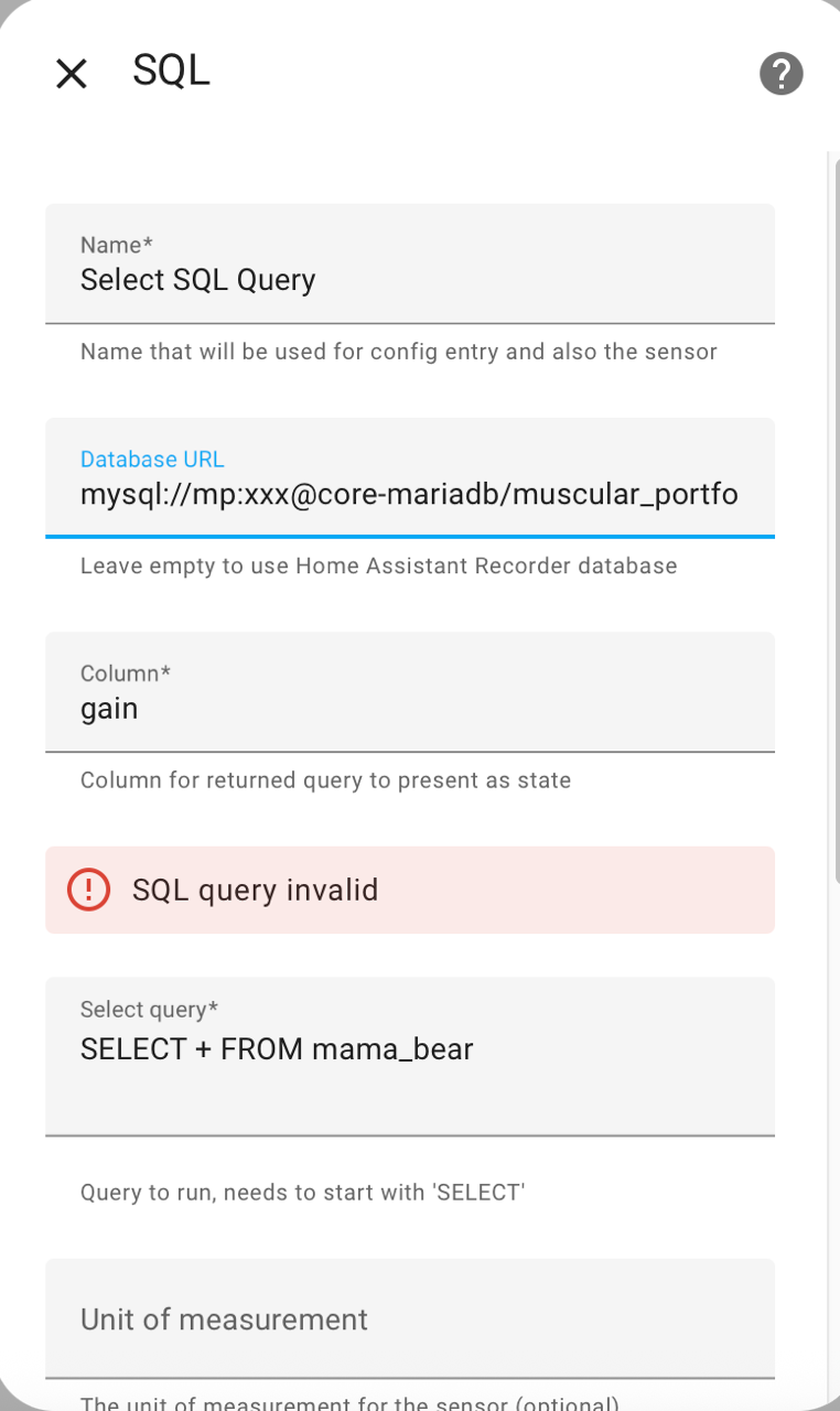

Try as I might, carefully following your advice and documentation, I can’t get SQL UI to work. I’ve checked for hidden chars, you name it. Well, maybe not. You may see the issue in an instant.
MariaDB log:
[2025-07-27 11:37:49 ](calendar:T7:2025-07-27 11:37:49 )51 [Warning] Access denied for user ‘mp’@‘172.30.32.1’ (using password: YES)
The image has my password obscured.
As I’ve mentioned before, I think it’s a permissions issue since I don’t use MariaDB as the HA recorder. MariaDB startup log shows:
INFO: Granting all privileges to mp on muscular_portfolio

I have the same Access denied error in my MariaDB logs, but the IP address 172.30.32.1 is apparently local and used by the docker container system - so probably a start up issue or similar, nothing more.
The user (mp) and password (xxxx) have to be correct, and the IP address (core-mariadb, I would use the full IP address and the port myself to be sure).
The database (muscular_portfolio) and (as you add) user mp has to have access rights to the database.
I found, in testing this, MariaDB to be unhappy with my SQL. Things like the table name are/are not in quotes, and the column used to ORDER BY did not appear to like being in capitals and quoted. No idea, but eventually it worked.
SELECT + FROM mama_bear is not an SQL command I recognise. I always thought it was *.
I am sure there will be an SQL query expert who knows how to get it to work, particularly on MariaDB

Errors in the URL will result in this error. Use of ’ single quotes seems to be important, and in my case I tried table name / columns with and without the quotes until it worked.
Wow. Thank you for doing that. I owe you a coffee.l or two.
Quotes: I tried double and not single quotes for table name, column and password. I only tried double quotes. I will try single.
IP: I tried core-mariadb,172.30.32.1:3306 with and without port. I was previously getting URL errors, but quickly fixed that. I would not expect MariaDB logs to show “Access denied for user ‘mp’@‘172.30.32.1’ (using password: YES)” when the IP address is wrong. Side note: My Python script has to add ‘&ssl_disabled=true’ to the URL ‘mysql://mp:xxx@core-mariadb/muscular_portfolio?charset=utf8mb4&ssl_disabled=true.’ SQL returns the error ‘URL invalid’ with this ssl add-on.
Query: I tried several queries, ones that MariaDB likes using phpMyAdmin. I made my query match yours for the screenshot.
Password: Absolutely has to be exactly correct. User ‘mp’ is correct, but ‘password’ must be the issue. SQL reaches MariaDB and rejects the user/password. Maybe I’ll create another user just for SQL.

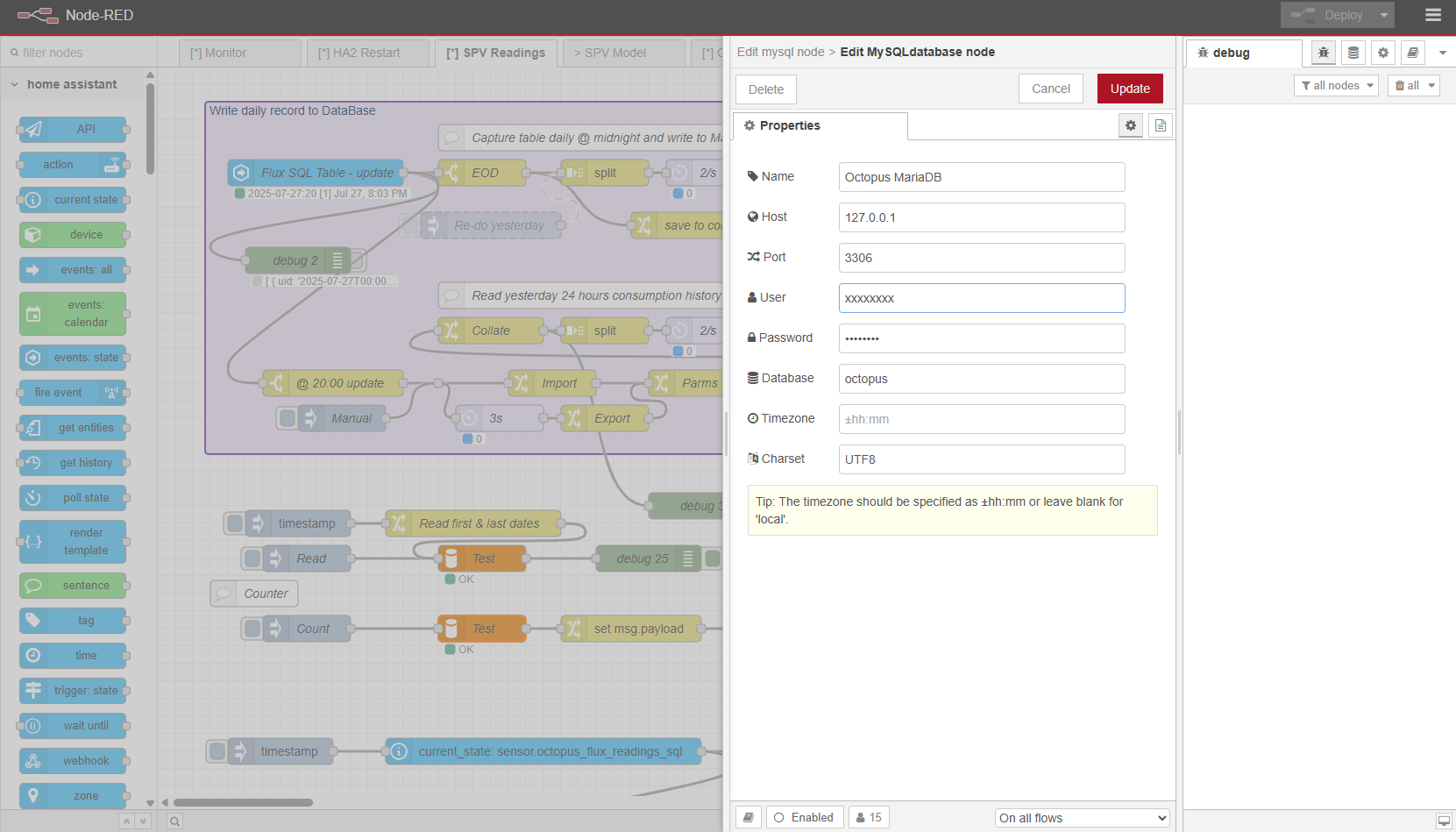

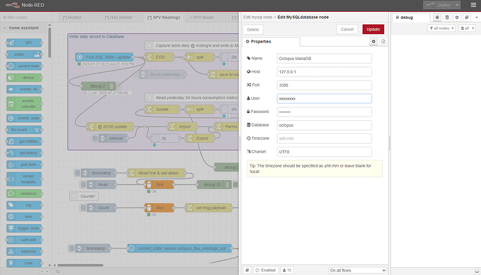

I do all my MariaDB work using Node-RED. I use the node-red-node-mysql node set, and have had no issues at all in both writing to and reading from the DB.
I run queries on the same machine (both Node-RED and MariaDB are running as HA add-ons) and use 127.0.0.1 as the IP address.
I can also run queries on a different machine, running Node-RED, and have to use the main DB machine IP address, but again I have never had any issues.
Node-RED is something else to load/learn but it does permit full use of the entire SQL table return, which is something the HA SQL integration cannot do.
