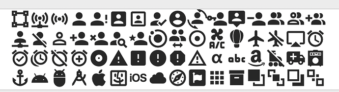

Is this the webfont file you are using? http://materialdesignicons.com/cdn/5.3.45/fonts/materialdesignicons-webfont.ttf
When I open it up I only get a very limited subset of characters to copy:
so how do I select the rest?

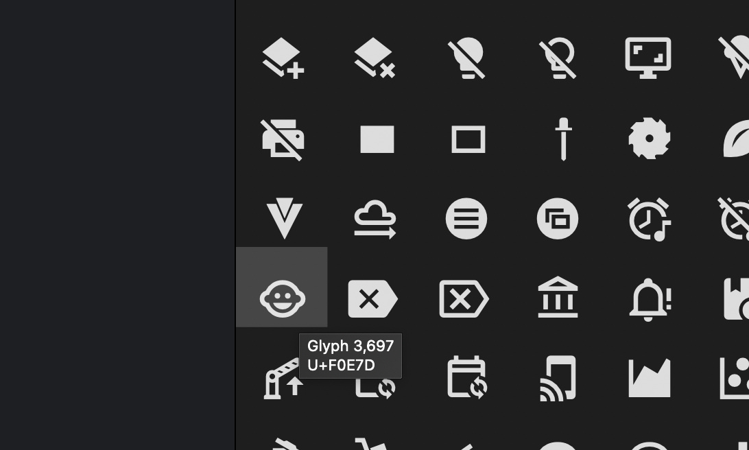

Yes it is this font!
Are you using MacOS?
If yes, select the “grid icon” on the upper left corner of the FontBook app to display all characters
Capture d’écran 2020-05-28 à 11.46.23
Great, thanks! So here is a quick summary for future people:
find the latest webfont by going to https://materialdesignicons.com/ and click the blue download at the top right.
Open it up with font book on a mac and after selecting the font use the grid icon to see all the icons available.
Go to this page http://materialdesignicons.com/cdn/5.3.45/ to see an overview of all the icons and use search to find the icon your interested in. Look at the bytecode.
In this case I am looking for F0E7D and now go back to font book, hover over a icon and you will see the current font byte code. Now you know if you need to scroll up or down to find the icon you are looking for. (The order is hexadecimal right to left so 0,1…9,A,B,C,D,E,F)
Once you find the one you need, copy it from the font-book and paste it into ESPHome to include it in your display.
