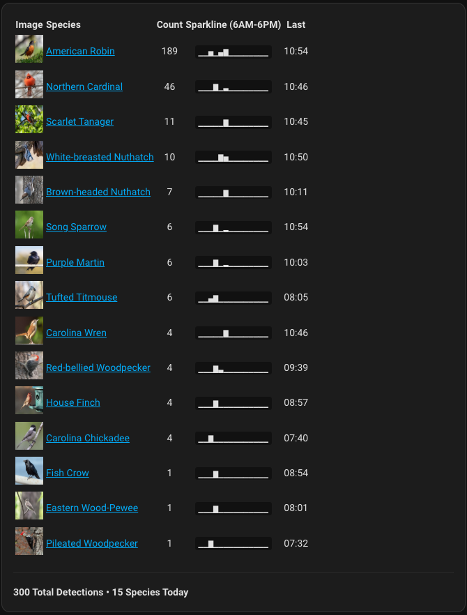

If it’s helpful, I managed to add the images to the markdown card:
{% if has_value('sensor.birdnet_daily_summary') %}
{% set species_data = state_attr('sensor.birdnet_daily_summary', 'species_list') %}
{% if species_data and species_data | count > 0 %}
| Image | Species | Count | Sparkline (6AM-6PM) | Last |
{% for bird in species_data | sort(attribute='latest_heard', reverse=true) | sort(attribute='count', reverse=true) %}
{#- Basic Info -#}
{%- set time = bird.latest_heard -%}
{%- set name = bird.common_name -%}
{%- set count = bird.count -%}
{%- set species_code = bird.species_code %}
{%- set ebird_url = "https://ebird.org/species/" ~ species_code %}
{%- set thumbnail = bird.thumbnail_url if bird.thumbnail_url is defined else "" %}
{#--- Sparkline Calculation (Full Day Aggregated - 14 slots) ---#}
{%- set hourly = bird.hourly_counts -%}
{%- set sparkline_str = "N/A" -%} {#- Default value -#}
{%- if hourly is defined and hourly is iterable and hourly | count == 24 -%}
{#- Aggregate counts: [0-6], 6..18, [18-24] (14 slots total, safe concatenation) -#}
{%- set early_sum = hourly[0:6] | sum -%}
{%- set middle_part = hourly[6:18] -%}
{%- set late_sum = hourly[18:24] | sum -%}
{%- set aggregated_counts = [early_sum] + middle_part + [late_sum] -%}
{# Check if list has expected count before finding max #}
{%- if aggregated_counts | count == 14 -%}
{#- Find Max for Scaling -#}
{%- set max_val = aggregated_counts | max -%}
{#- Define Sparkline Characters (7 levels, U+2581 to U+2587) -#}
{%- set spark_chars = ['▁', '▂', '▃', '▄', '▅', '▆', '▇'] -%}
{%- set sparkline = namespace(text="") -%}
{%- for v in aggregated_counts -%}
{#- Map value to character index (0-6), scale factor 7, max index 6 -#}
{%- set char_index = ([0, (v * 7 / max_val)|int , 6] | sort)[1] if max_val > 0 else 0 -%}
{#- Append character -#}
{%- set sparkline.text = sparkline.text ~ spark_chars[char_index] -%}
{%- endfor -%}
{%- set sparkline_str = sparkline.text -%}
{%- else -%}
{% set sparkline_str = "?" * 12 %}
{%- endif -%}
{%- endif -%}
{#--- End Sparkline Calculation ---#}
{#- Output Row with Image -#}
| {% if thumbnail %}<img src="{{ thumbnail }}" width="40" height="40" style="border-radius: 50%; object-fit: cover;">{% else %}🐦{% endif %} | [{{ name }}]({{ ebird_url }}) | {{ count }} | `{{ sparkline_str }}` | {{ today_at(time) | as_timestamp | timestamp_custom('%H:%M', true) }} |
{% endfor %}
**{{ species_data | sum(attribute='count') | int }} Total Detections • {{ species_data | count }} Species Today**
{% else %}
No bird species data available or list is empty.
{% endif %}
{% else %}
BirdNET-Go API is not available.
{% endif %}
