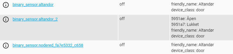

Does this config work? I mean, if you go to Developer Tools -> States, do you see binary_sensor.altandor or something similar?
Yes. Actually I have three of them (because failing to get them to work so many times).
None of them seems to work as both dont react to the sensor.

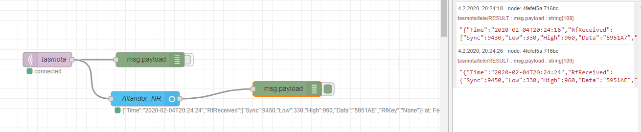

4.2.2020, 20:15:02node: c619d65.d483428
tasmota/tele/RESULT : msg.payload : string[109]
"{"Time":"2020-02-04T20:14:59","RfReceived":{"Sync":9470,"Low":330,"High":960,"Data":"5951AE","RfKey":"None"}}"

… and then I can pick it up with Node-Red using the sensor-node:
