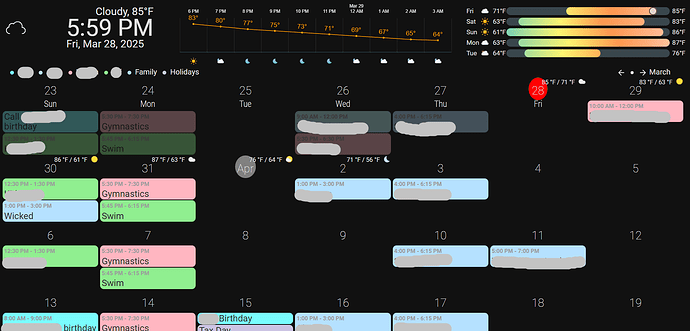

DIY Family Calendar (Skylight)
If it would be helpful, here is my full family calendar dashboard yaml.
I removed the config-template-card portion as the week-planner-card supports paging through months and picking calendars to show/hide now. We also never changed the durations we want to see in my family.
This uses Kiosk Mode to make it fullscreen on my Crestron 1070 display and a couple clock/weather widgets we like.
There are no helpers/etc needed, only need to install the necessary items through HACS and configure which calendars you want shown.
Here’s the code as it sits now. I’m sure the css can use some work, and I’d love feedback to make it better :slight_smile:

Thanks everyone for your hard work on this, can’t wait to see the tasks/chores integrations!
