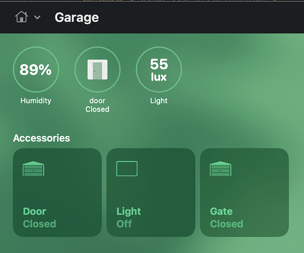

I even did a (questionably useful lol) integration with HomeKit. It will remain a bit janky though until Apple adds an EV type of entity to HomeKit (which is hopefully not too far away!).
