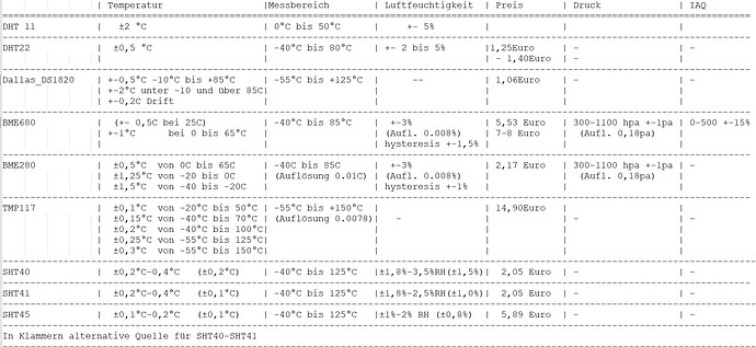

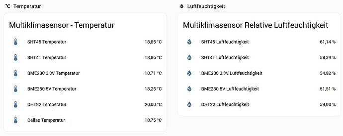

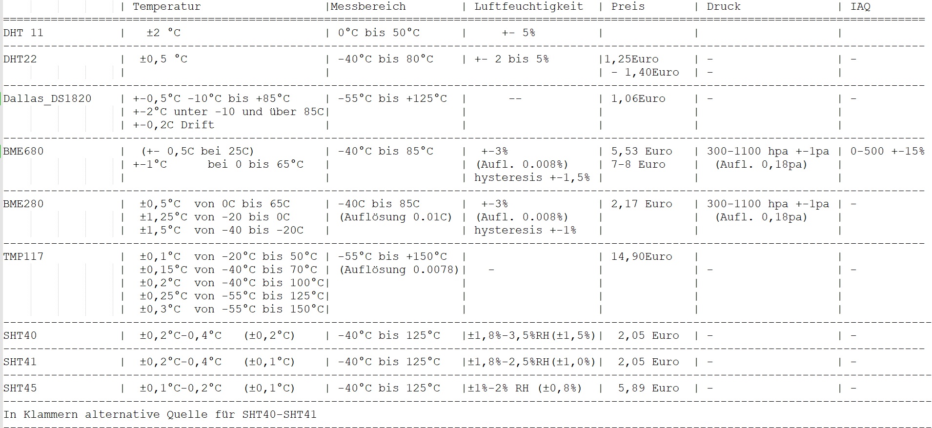

I would also recommend buying a few simple sensors and connecting them to an ESP. I conducted a comparison test with the sensors I have at home. I arranged all the sensors next to each other in a housing and read them using a D1 Mini Pro.
The tested sensors are relatively easy to integrate into HomeAssistant via ESPHome.
Sensor information:
Sensor comparison test:
(Except for the DHT22 and the Dallas sensor, you still have to build a small housing for the sensors.)
SHT4x sensors are the clear winner there.

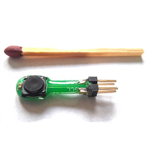

I make my own with these: https://www.aliexpress.com/item/1005005753502123.html
Prices of that specific link are little bit weird, I agree. But SHT40 costs 4.50 eur, which is very reasonable. The probe enclosure is (supposed to be) water proof.

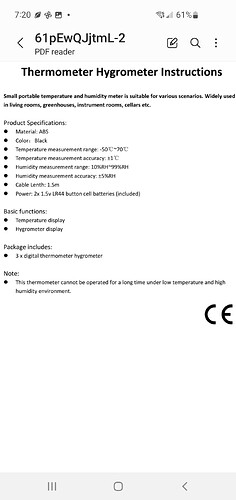

Sais who?? The datasheet sais otherwise and its not recommended to use with high humidity…
Also, i dont see anywhere in the documentation where it specifies what type of sensor exactly that is and just because it has 3 wires/pins on it, that doesn’t automatically mean its a certain type/model.
Hell, nearly all temp/humidity sensors have 3 connection points and they are very different types of sensors that require specific drivers for whatever chip its using.
You’re far better off if you just go buy appropriate sensors for the use case instead of trying to modify one that wasn’t meant for an environment you need it for and doing that is really just asking for problems, either right away or later on when its inconvenient to have to go fix…
