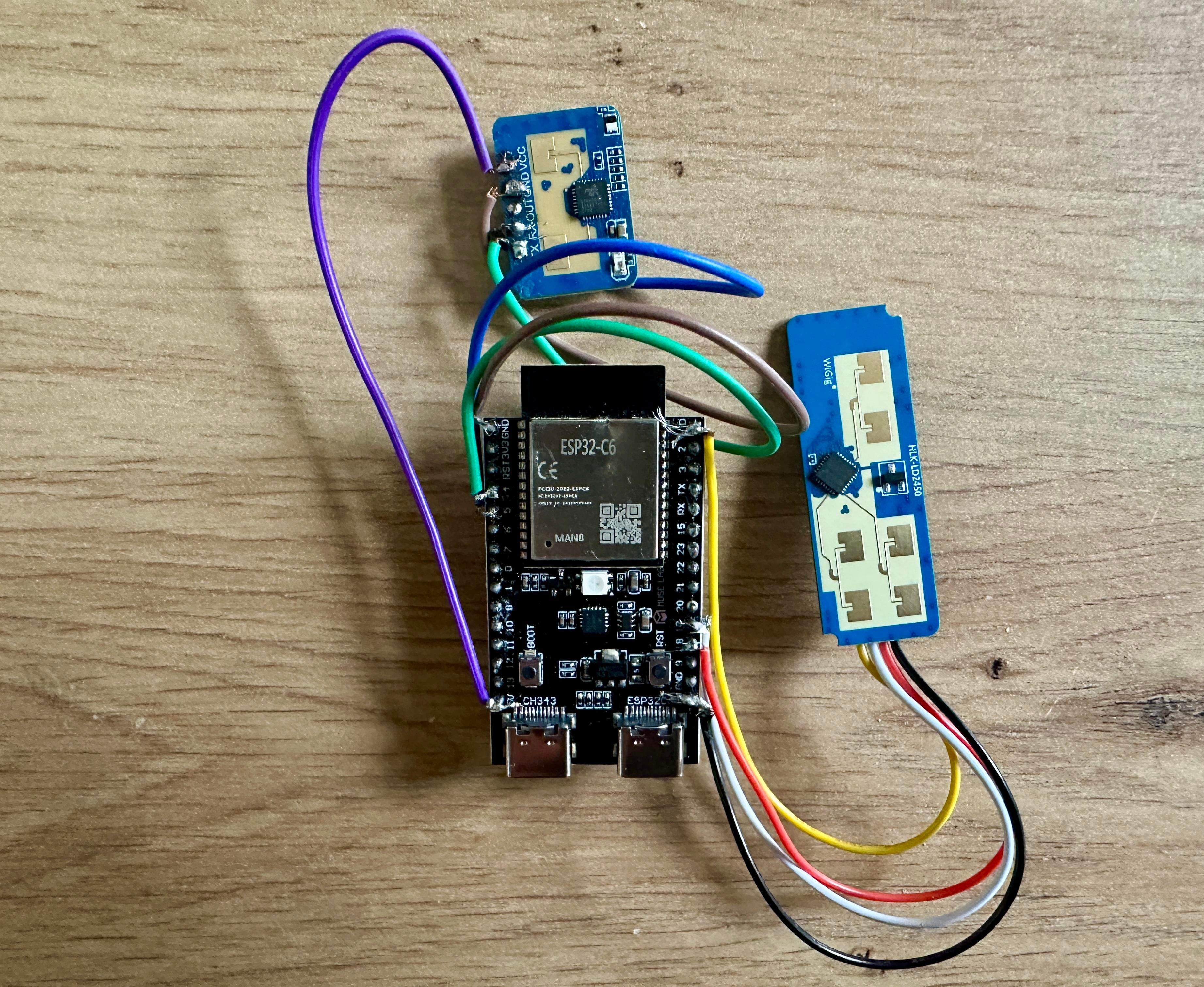

This is a continuation of the awesome work by Smart Home Scene DIY Zigbee mmWave Presence Sensor which uses an ESP32-C6 with an LD2410 for Zigbee presence detection. My enhanced version adds a second sensor (LD2450) for multi-target tracking and zone-based detection.

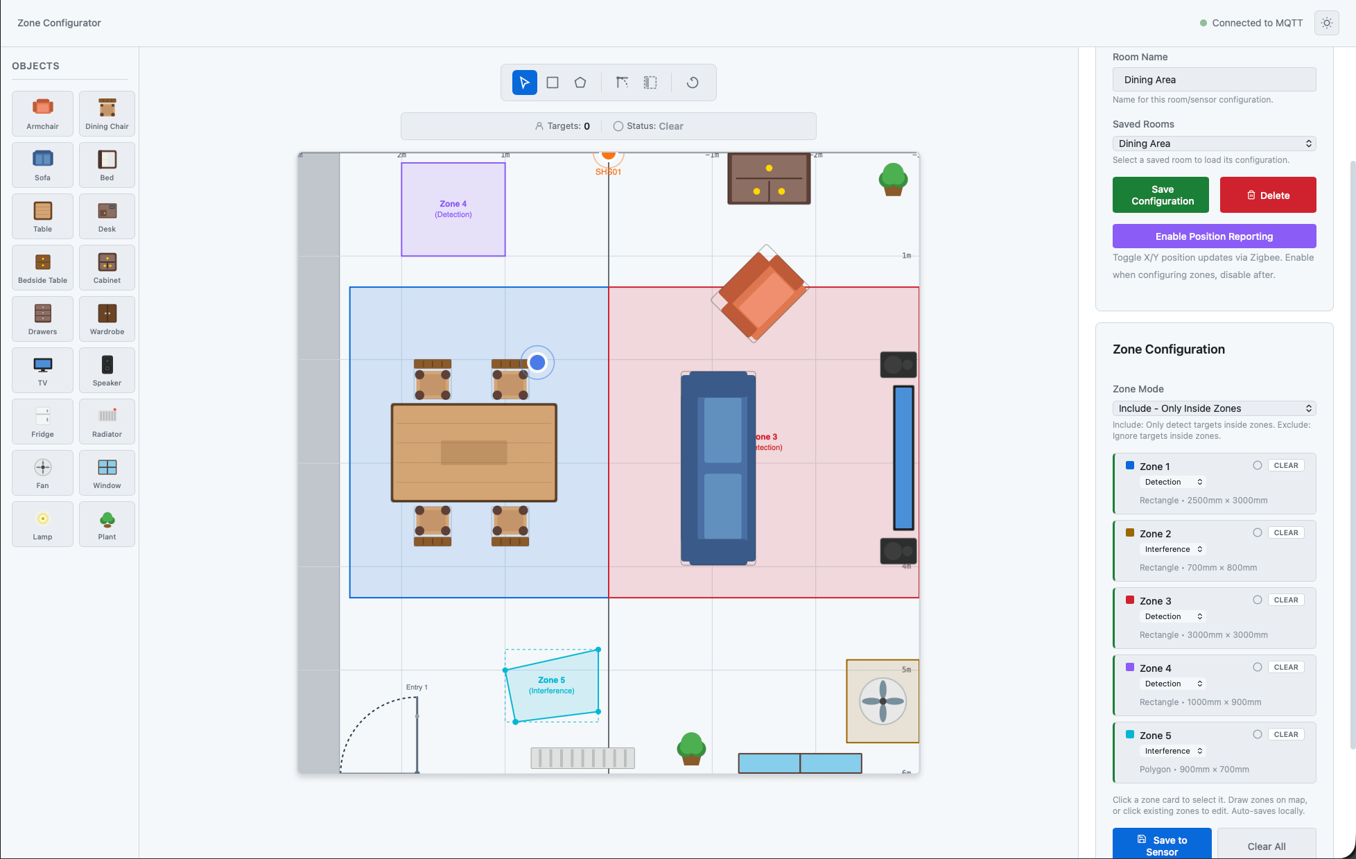

  • Zone Configurator: I’ve created a Home Assistant add-on that lets you draw zones on an interactive canvas, place furniture on a floor plan, and see real-time target positions
Hardware:
  • ESP32-C6 (same as original)
  • LD2410C (same as original)
  • LD2450 (added)
The flashing process from the original Smart Home Scene guide still applies. Once flashed, you just need to add the external converter to Zigbee2MQTT.
Zone Configurator HA Addon:

Sensor interference: During testing, I discovered the LD2450 was causing interference on the LD2410C, random false presence triggers every few minutes with sudden energy spikes when no one was in the room. The solution was dual sensor cross-validation: the LD2410 presence only reports if the LD2450 also sees at least one target. This eliminated the false positives while keeping reliable detection.
Config Mode & Zigbee traffic: The firmware includes a Config Mode for live tracking and zone configuration (can be triggered via software or the physical button on the ESP32 C6). This mode streams X/Y coordinates to the Zigbee network, which generates a lot of traffic. I’ve been using it for 5-10 minutes at a time over 2 weeks of testing without any network crashes, but all setups are different. My recommendation: only activate Config Mode when configuring zones and turn it off immediately after. When Config Mode is OFF, the sensor still processes zones locally, only the real-time position streaming is disabled.
