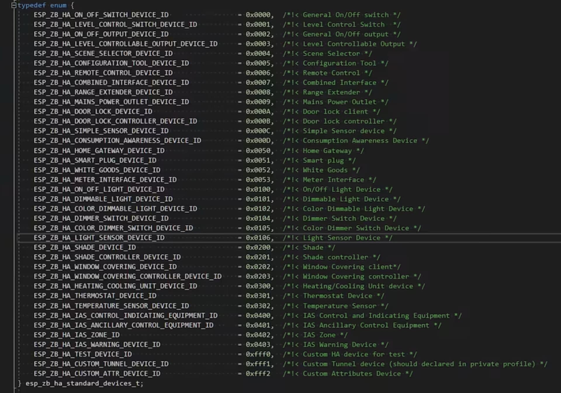

I did it with crappy things (not crappy but it was a fight to have it with actions in Z2m) on ESP32-C6. Now works like a charm.
I have firmware with:
DS18B20 sensor
DHT21 sensor
onOff light or wharever
Multistateinput for single / double or whatever
Multistateoutput to have for example fan control off/low/mid/high or whatever
And the converter for Z2M.
Was a nightmare to have the correct value from the correct endpoint but now is stable.
Is in playground mode, going to cleanup code.
PS: Added terminal to be able to control ESP32 from terminal also
PPS: Did it with tasks to have more control on things since for playground using arduino ESP32 port for ease of testing.
It rocks now
