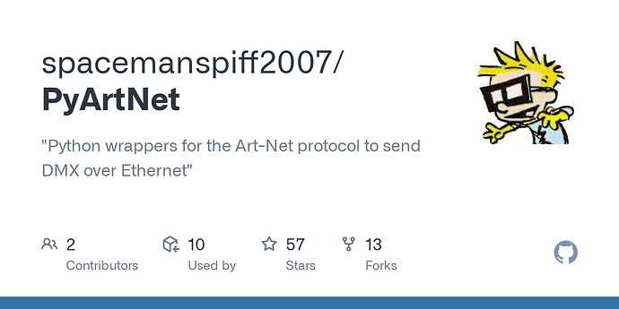

I don’t know of a HA integration that sends DMX through USB, it’s not a standard and every brand has its own specification. Currently ha-artnet-led supports ArtNet, sACN and KiNet v1.
You could try to running Open Lighting Architecture | as an integration layer, which supports the ENTTEC USB interface, so you may be able to run that on your mini-pc. It would look like this, then:
HA —ArtNet—> OLA —USB—> DMX

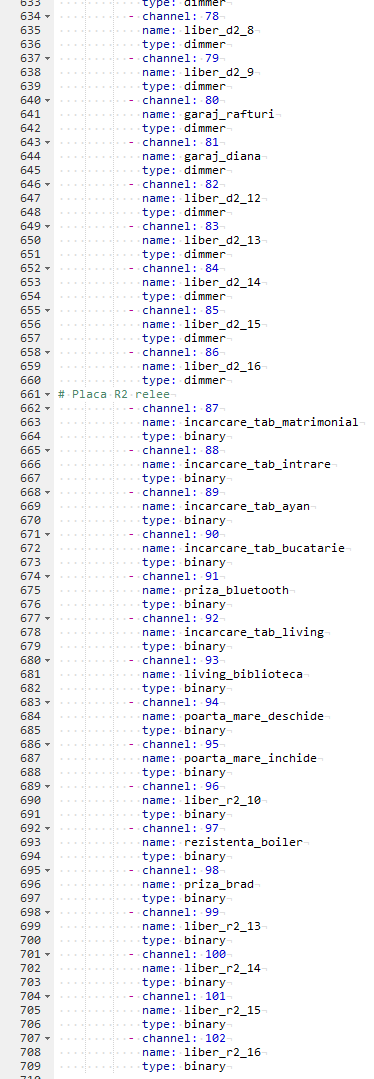

I have 102 channels! Everything is OK

The HA integration directly uses the PyArtNet that you linked. Your Pknight bi-directional ArtNet Controller CR011R, where is it now?
Normally you should be able to hook it up like this:
Mini-PC with HA -----> ArtNet Controller -----> DMX
