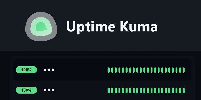

I use Uptime-Kuma which I would like to see added to the official addons, because it’s very useful. And has built in realtime alerting.
uptime-kuma looks cool, does it use dig to test DNS speed?
I’m not sure if the latency it returns is via DIG, or if it is a ping response. Whatever the case, it returns a latency, and marks the service as down if the query could not be resolved.
