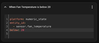

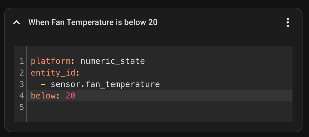

Make the switch the condition, and the temperature change the trigger.
That way, as long as there’s a change in temperature, automation is triggered.
If your toggle helper is ON, then it’ll perform actions. Otherwise, it’ll stop the automation.
In my opinion, you don’t need to put the temperature as the condition unless you have further requirements for that. The trigger already serves as “proof that your home is in that state”.
This will keep running each time your sensor hits the trigger, and then automation checks the condition (where helper is ON).
Example of a trigger when temp falls below 20℃:

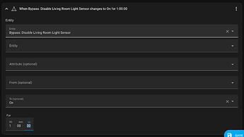

Automatically turning off the helper
If you want the toggle helper to be turned off after lets say 60 minutes, you can then add another trigger to the same automation under a different trigger ID:
toggle helper on for duration of 1 hour
Example:
Then add an if…then action, where if triggered by the above trigger, set the toggle to off. The benefit as compared to the timer method is, your automation won’t have to keep running, and it’ll still trigger after an hour to automatically toggle your helper.
