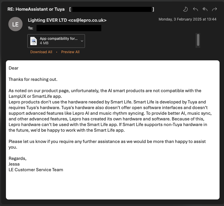

I emailed Lepro about this but the response I got was basically “no we never have and never will”

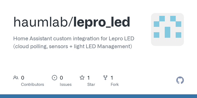

Here you are my custom integration for Lepro LED:
Thankyou for this!!!
@barry.wootton Please consider a donation

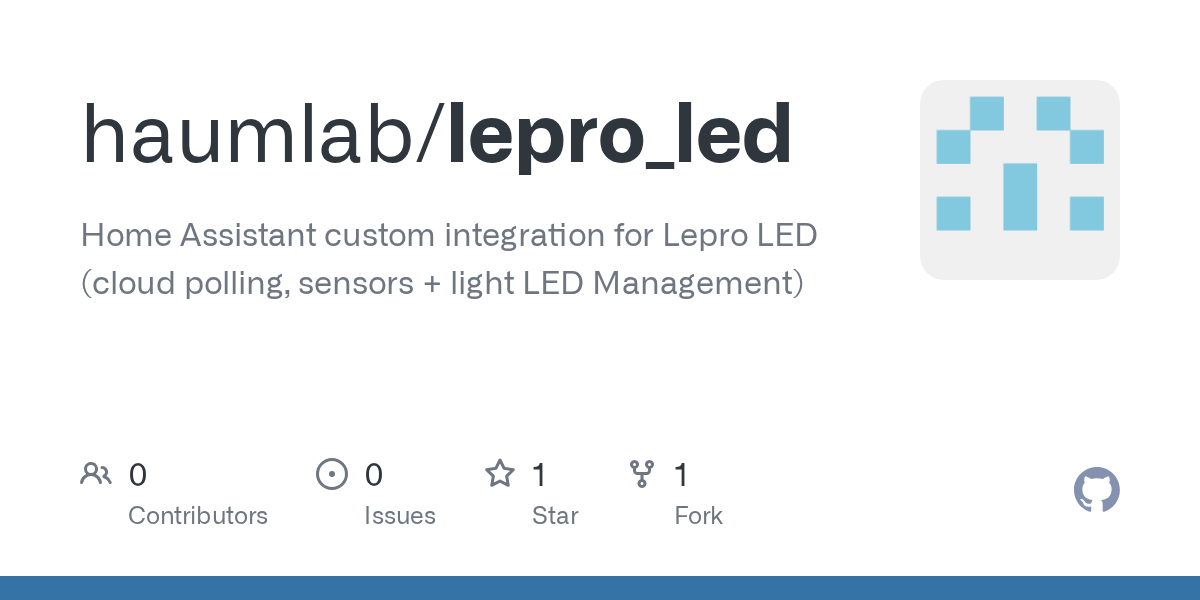

So i found out that Stefano’s project doesn’t work with the B1, so I forked it and then edited the code to fully work with the B1.
Fully works, tested however you do lose some of the effects that I might be able to work on adding.
Im using this successfully with a number of the lepro products so thanks for the work :). I cant see how to set specific rgb modes though, only basic colours. That could be due to being new to HA though. Any pointers?
