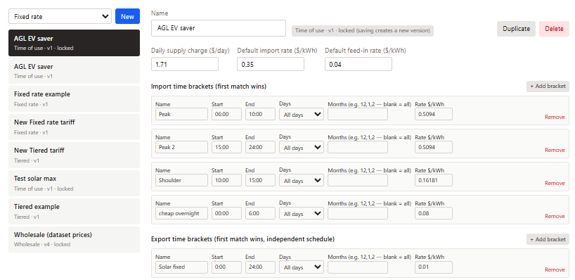

  3. set up your energy plan under ‘tarrifs’

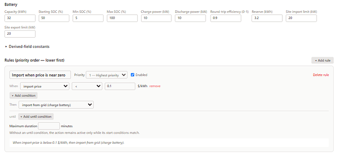

  4. pick an automation strategy and save it, make sure you pick your tarrif as the one used by the strategy.

Setting Tarrifs
Automation rules

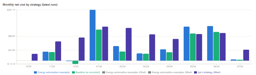

Comparing strategies

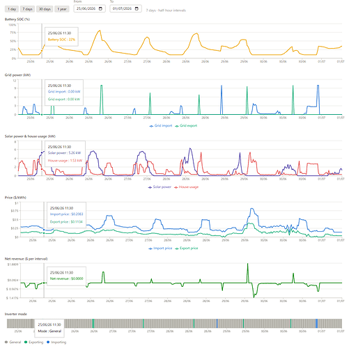

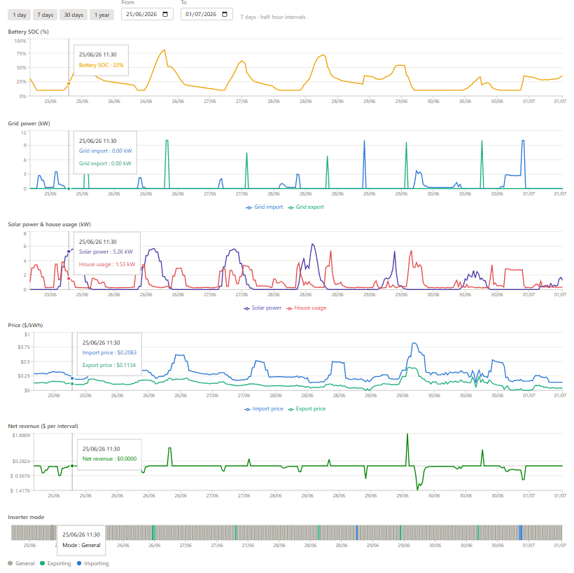

Viewing simulation timeline

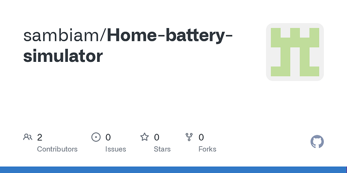

And it’s fully open source - the code is on GitHub. I built this purely to answer a question for myself, so it’s not polished into a general-purpose product, but feel free to use it, fork it, or build your own (probably better) version from it. If you have ideas for improving it, I’d love to hear them.
It looks like your automations and strategy made no discernible improvement and actually made things worse compared to the baseline?
I guess that’s good to know.
Indeed, it was nice to see I haven’t been pouring money down the drain. The biggest challenge I had was trying to replicate my node red flows and template entities which clearly I wasn’t quite able to match but it was close enough for now. I’d eventually like to automate it a bit more so that I can have it iterate through a bunch of different rules and thresholds to try and optimise for price but I can see that getting complicated.
