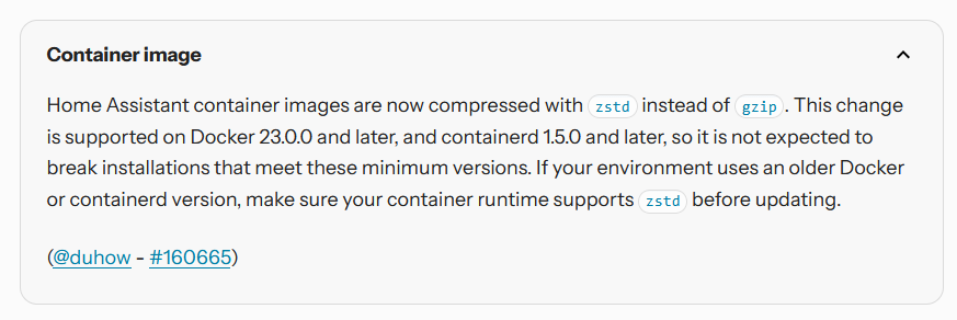

The Docker image this month uses features from the latest release Docker code.
You may need to update your version iof Docker…

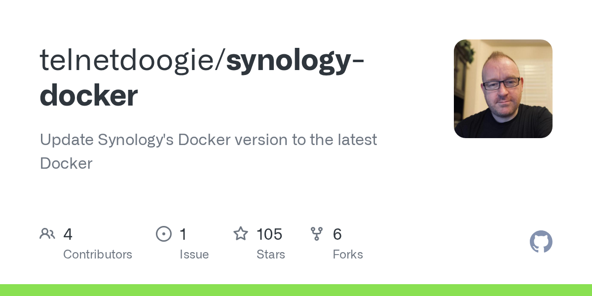

Maybe this can help, did not try it yet …
Update
Could not get telnetdoogie approach to update Docker working on my DS218+. Some prerequisites missing. So decided to manually update DSM 7.1 to 7.3. Please note that you will then lose video station (I did not use it).
Upgrade completed and then followed this approach to get my zigbee and zwave USB dongles working again.
All succesfull and now running Homeassistant 2026.3!

It’s mentioned here in 2026.3 2026.3: A clean sweep - Home Assistant
