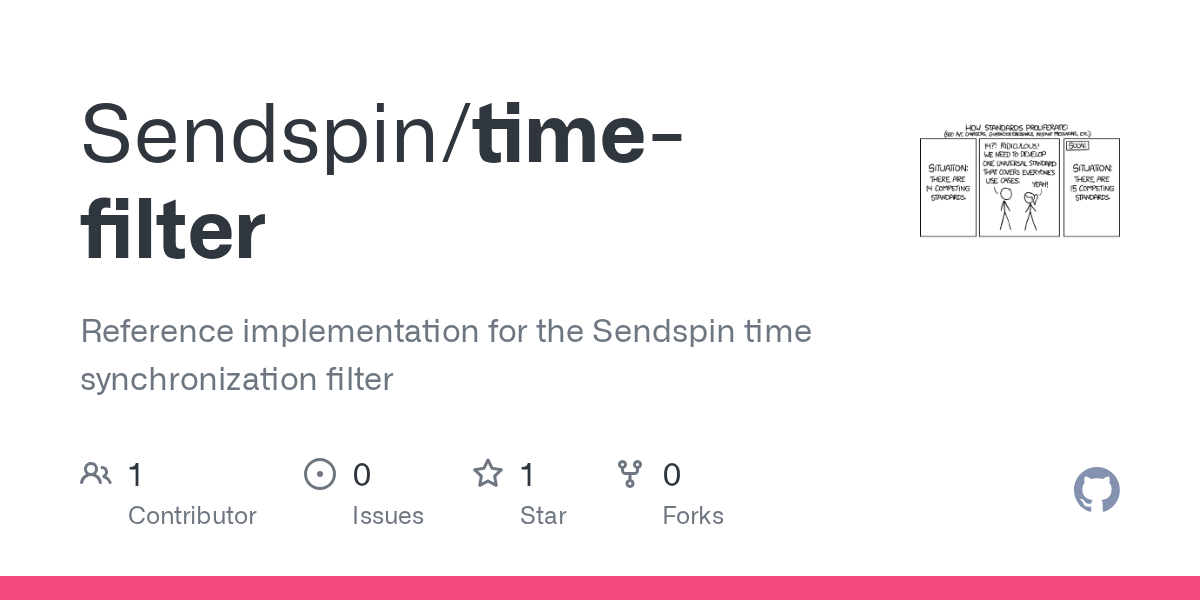

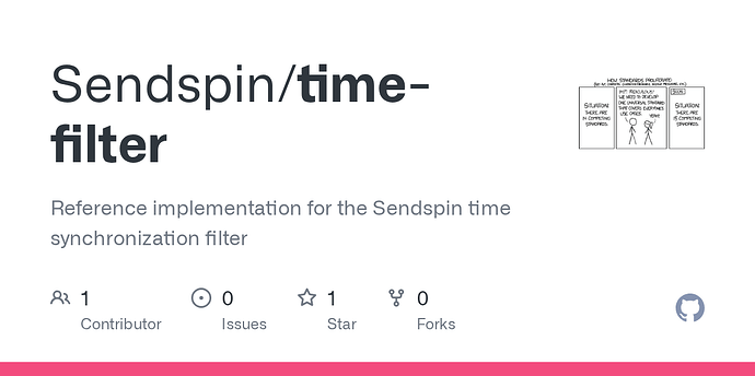

Sendspin has Kalman setting I believe that I believe affects clock and maybe this has relation to buffer. I believe it’s added under sendspin_hub in yaml but I don’t have example to show. Below is info on kalman.
Thank you for the info & link. I’ll look into it.
