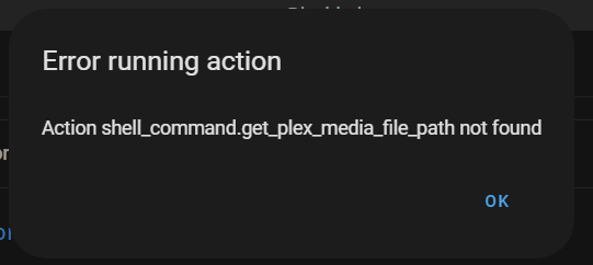

I added the YAML for shell_command in configuration.yaml, but when I reload the YAML, I don’t see it. It’s not working in my automations either:
But it’s in configuration.yaml:
shell_command:
  get_plex_media_file_path: >
    python3 /config/scripts/get_plex_media_file_path.py --plex_server_domain "{{ plex_server_domain }}" --plex_server_port "{{ plex_server_port }}" --plex_token "{{ plex_token }}" --rating_key "{{ rating_key }}"
