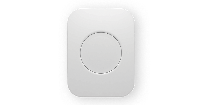

Hi, I am using a few of these buttons without problem, but only indoor. So be sure to check your weather condition at the installation point as well as your zigbee signal.

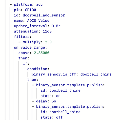

parts:
china doorbell (from ali) with button piezo (without batt)
esp32 mini
so, button outdoors
main block in the home
next: just disassemble main block, find 5v. powering esp32 mini
connect D0 pin to doorbell LED
esphome.
I use a couple of these Frient Zigbee buttons, which are waterproof.
They also have this compatibility table - the only manufacturer I’ve come across that does anything so helpful.
battery drain after 3 month device.
after 1y now looks is very ugly.
just FYI. but let’s try, may be you luck.
which one of the three suggestions do you mean?
@HA-Utrecht35
if u asking me… i have had this button.
and sorry, cuz UA winter is not like in Poland, Germany etc.
-5C…+5C sometimes -10*C (one - two days)
Also depends on how many visitors you have, I expect. ![]()
