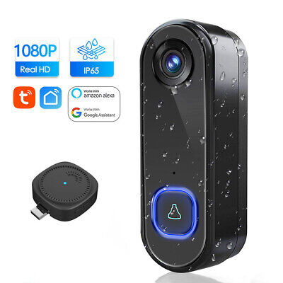

1: My first video doorbell was one of these generic Tuya compatible ones:
Frankly, it was useless. Poor WiFi connectivity, 5-10 seconds lag, poor image quality at night.
