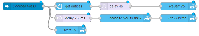

Hi, I’m very new to Node-RED and having great fun learning. I’ve been trying to work on a pretty typical sequence for a Doorbell chime.
I’ve used a lot of information from this post.
Basically it boils down to:
  1. Doorbell pressed
  2. Capture current volume of all Alexa devices
  3. Increase Volume to 90% for all Alexa devices
  4. Play Chime
  5. Revert Volume back
I have managed to achieve this (after an embarrassing amount of time figuring it out) with the following:
[{"id":"393db8d.1060848","type":"api-current-state","z":"6c7101b0.e0c0a","name":"Echo Show Volume?","server":"bcca64cb.debed8","version":1,"outputs":1,"halt_if":"","halt_if_type":"str","halt_if_compare":"is","override_topic":false,"entity_id":"media_player.george_s_echo_show","state_type":"str","state_location":"payload","override_payload":"msg","entity_location":"data","override_data":"msg","blockInputOverrides":false,"x":480,"y":620,"wires":[["2346232e.a7630c"]]},{"id":"2346232e.a7630c","type":"change","z":"6c7101b0.e0c0a","name":"Extract Current Volume","rules":[{"t":"set","p":"payload","pt":"msg","to":"data.attributes.volume_level","tot":"msg"}],"action":"","property":"","from":"","to":"","reg":false,"x":730,"y":620,"wires":[["7d88e206.6a978c"]]},{"id":"5b70f2f7.eec36c","type":"api-call-service","z":"6c7101b0.e0c0a","name":"Increase Vol. to 90%","server":"bcca64cb.debed8","version":1,"debugenabled":false,"service_domain":"media_player","service":"volume_set","entityId":"media_player.george_s_echo_show, media_player.george_s_echo_dot, media_player.george_s_echo, media_player.george_s_sonos_one","data":"{\"volume_level\":\"0.9\"}","dataType":"json","mergecontext":"","output_location":"","output_location_type":"none","mustacheAltTags":false,"x":700,"y":860,"wires":[["f474c76e.3548d8"]]},{"id":"6ef2e671.997bb8","type":"api-call-service","z":"6c7101b0.e0c0a","name":"Revert Vol.","server":"bcca64cb.debed8","version":1,"debugenabled":false,"service_domain":"media_player","service":"volume_set","entityId":"media_player.george_s_echo_show","data":"{\"volume_level\":\"{{payload}}\"}","dataType":"json","mergecontext":"","output_location":"","output_location_type":"none","mustacheAltTags":false,"x":1110,"y":620,"wires":[[]]},{"id":"f474c76e.3548d8","type":"api-call-service","z":"6c7101b0.e0c0a","name":"Play Chime","server":"bcca64cb.debed8","version":1,"debugenabled":false,"service_domain":"media_player","service":"play_media","entityId":"media_player.george_s_echo_show, media_player.george_s_echo_dot, media_player.george_s_echo, media_player.george_s_sonos_one","data":"{\"media_content_id\":\"amzn_sfx_doorbell_chime_01\",\"media_content_type\":\"sound\"}","dataType":"json","mergecontext":"","output_location":"","output_location_type":"none","mustacheAltTags":false,"x":970,"y":860,"wires":[[]]},{"id":"7d88e206.6a978c","type":"delay","z":"6c7101b0.e0c0a","name":"","pauseType":"delay","timeout":"4","timeoutUnits":"seconds","rate":"1","nbRateUnits":"1","rateUnits":"second","randomFirst":"1","randomLast":"5","randomUnits":"seconds","drop":false,"x":940,"y":620,"wires":[["6ef2e671.997bb8"]]},{"id":"e1ad8bc8.459ac8","type":"api-current-state","z":"6c7101b0.e0c0a","name":"Echo Volume?","server":"bcca64cb.debed8","version":1,"outputs":1,"halt_if":"","halt_if_type":"str","halt_if_compare":"is","override_topic":false,"entity_id":"media_player.george_s_echo","state_type":"str","state_location":"payload","override_payload":"msg","entity_location":"data","override_data":"msg","blockInputOverrides":false,"x":460,"y":680,"wires":[["6ff5f09b.dd361"]]},{"id":"80d9862f.a02cc8","type":"api-current-state","z":"6c7101b0.e0c0a","name":"Echo Dot Volume?","server":"bcca64cb.debed8","version":1,"outputs":1,"halt_if":"","halt_if_type":"str","halt_if_compare":"is","override_topic":false,"entity_id":"media_player.george_s_echo_dot","state_type":"str","state_location":"payload","override_payload":"msg","entity_location":"data","override_data":"msg","blockInputOverrides":false,"x":470,"y":740,"wires":[["8783ccd9.a7497"]]},{"id":"9a17f5f7.2d7918","type":"api-current-state","z":"6c7101b0.e0c0a","name":"Sonos Volume?","server":"bcca64cb.debed8","version":1,"outputs":1,"halt_if":"","halt_if_type":"str","halt_if_compare":"is","override_topic":false,"entity_id":"media_player.george_s_sonos_one","state_type":"str","state_location":"payload","override_payload":"msg","entity_location":"data","override_data":"msg","blockInputOverrides":false,"x":460,"y":800,"wires":[["4ebbd74e.4c8248"]]},{"id":"6ff5f09b.dd361","type":"change","z":"6c7101b0.e0c0a","name":"Extract Current Volume","rules":[{"t":"set","p":"payload","pt":"msg","to":"data.attributes.volume_level","tot":"msg"}],"action":"","property":"","from":"","to":"","reg":false,"x":730,"y":680,"wires":[["91c6387d.3f9148"]]},{"id":"8783ccd9.a7497","type":"change","z":"6c7101b0.e0c0a","name":"Extract Current Volume","rules":[{"t":"set","p":"payload","pt":"msg","to":"data.attributes.volume_level","tot":"msg"}],"action":"","property":"","from":"","to":"","reg":false,"x":730,"y":740,"wires":[["df96f779.f0bcb8"]]},{"id":"4ebbd74e.4c8248","type":"change","z":"6c7101b0.e0c0a","name":"Extract Current Volume","rules":[{"t":"set","p":"payload","pt":"msg","to":"data.attributes.volume_level","tot":"msg"}],"action":"","property":"","from":"","to":"","reg":false,"x":730,"y":800,"wires":[["e989936.ab50c7"]]},{"id":"cf84316b.e8add","type":"api-call-service","z":"6c7101b0.e0c0a","name":"Revert Vol.","server":"bcca64cb.debed8","version":1,"debugenabled":false,"service_domain":"media_player","service":"volume_set","entityId":"media_player.george_s_echo","data":"{\"volume_level\":\"{{payload}}\"}","dataType":"json","mergecontext":"","output_location":"","output_location_type":"none","mustacheAltTags":false,"x":1110,"y":680,"wires":[[]]},{"id":"91c6387d.3f9148","type":"delay","z":"6c7101b0.e0c0a","name":"","pauseType":"delay","timeout":"4","timeoutUnits":"seconds","rate":"1","nbRateUnits":"1","rateUnits":"second","randomFirst":"1","randomLast":"5","randomUnits":"seconds","drop":false,"x":940,"y":680,"wires":[["cf84316b.e8add"]]},{"id":"f2b8d75a.0329b8","type":"api-call-service","z":"6c7101b0.e0c0a","name":"Revert Vol.","server":"bcca64cb.debed8","version":1,"debugenabled":false,"service_domain":"media_player","service":"volume_set","entityId":"media_player.george_s_echo_dot","data":"{\"volume_level\":\"{{payload}}\"}","dataType":"json","mergecontext":"","output_location":"","output_location_type":"none","mustacheAltTags":false,"x":1110,"y":740,"wires":[[]]},{"id":"df96f779.f0bcb8","type":"delay","z":"6c7101b0.e0c0a","name":"","pauseType":"delay","timeout":"4","timeoutUnits":"seconds","rate":"1","nbRateUnits":"1","rateUnits":"second","randomFirst":"1","randomLast":"5","randomUnits":"seconds","drop":false,"x":940,"y":740,"wires":[["f2b8d75a.0329b8"]]},{"id":"4bd2d0ce.adf9c","type":"api-call-service","z":"6c7101b0.e0c0a","name":"Revert Vol.","server":"bcca64cb.debed8","version":1,"debugenabled":false,"service_domain":"media_player","service":"volume_set","entityId":"media_player.george_s_sonos_one","data":"{\"volume_level\":\"{{payload}}\"}","dataType":"json","mergecontext":"","output_location":"","output_location_type":"none","mustacheAltTags":false,"x":1110,"y":800,"wires":[[]]},{"id":"e989936.ab50c7","type":"delay","z":"6c7101b0.e0c0a","name":"","pauseType":"delay","timeout":"4","timeoutUnits":"seconds","rate":"1","nbRateUnits":"1","rateUnits":"second","randomFirst":"1","randomLast":"5","randomUnits":"seconds","drop":false,"x":940,"y":800,"wires":[["4bd2d0ce.adf9c"]]},{"id":"9d5a44d.6f3f5b8","type":"delay","z":"6c7101b0.e0c0a","name":"","pauseType":"delay","timeout":"250","timeoutUnits":"milliseconds","rate":"1","nbRateUnits":"1","rateUnits":"second","randomFirst":"1","randomLast":"5","randomUnits":"seconds","drop":false,"x":450,"y":860,"wires":[["5b70f2f7.eec36c"]]},{"id":"85319993.09ff38","type":"server-events","z":"6c7101b0.e0c0a","name":"Doorbell Press","server":"bcca64cb.debed8","event_type":"doorbird_doorbell_button","exposeToHomeAssistant":false,"haConfig":[{"property":"name","value":""},{"property":"icon","value":""}],"waitForRunning":true,"x":120,"y":740,"wires":[["393db8d.1060848","e1ad8bc8.459ac8","9a17f5f7.2d7918","80d9862f.a02cc8","9d5a44d.6f3f5b8","2906112a.a4694e"]]},{"id":"2906112a.a4694e","type":"api-call-service","z":"6c7101b0.e0c0a","name":"Alert TV","server":"bcca64cb.debed8","version":1,"debugenabled":false,"service_domain":"notify","service":"lounge_tv","entityId":"","data":"{\"message\":\"Doorbell\"}","dataType":"json","mergecontext":"","output_location":"","output_location_type":"none","mustacheAltTags":false,"x":440,"y":920,"wires":[[]]},{"id":"bcca64cb.debed8","type":"server","name":"Home Assistant","addon":true}]
However, I don’t think its the most efficient way of doing things, so it would be great to get some feedback from more experienced users. I feel like things could be condensed more with a function node, but I do like the visibility of the current setup.
Speed is the most important factor, and naturally grabbing the volume attribute of each device does slow things down a little when compared to going direct to a call service node, I’ve tried to mitigate this by using a very short delay before running the Increase Vol. to 90% node. Do you think this is best or would it just be as fast (or faster) to have the Increase Vol. to 90% node triggered by the payload from the Extract Current Volume nodes?
Also, its a bit of a bodge with the 4 second delay, it would be cleaner to have a the Revert Vol. nodes kick in after the chime has played but I’m not entirely sure how to set that up.
And finally, as for the Doorbell Press ‘events: all’ node; is it best practice to avoid this node when possible? Would an events state node be a faster (or perhaps less resource heavy) option? The only issue I have with the events state node is that I’m using the Doorbird Integration which triggers an event on doorbell press so doesn’t have an entity that I could use, so I’m unsure on how that would work.
Any feedback would be greatly appreciated, thanks.
G
Multiple current-state nodes really aren’t slowing you down. They don’t make a call to HA as they just search the cached value that is already stored in NR.
Using the events all node is a valid option for this use case.
None of these examples are tested.
Here’s one of using the get-entities node and some message variables to cut down on the number of nodes used but it’s purely cosmetic compared to your version.
[{"id":"52aa9190.67a2d","type":"api-call-service","z":"ffbd7f06.4a014","name":"Increase Vol. to 90%","version":1,"debugenabled":false,"service_domain":"media_player","service":"volume_set","entityId":"media_player.george_s_echo_show, media_player.george_s_echo_dot, media_player.george_s_echo, media_player.george_s_sonos_one","data":"{\"volume_level\":\"0.9\"}","dataType":"json","mergecontext":"","output_location":"","output_location_type":"none","mustacheAltTags":false,"x":548,"y":1776,"wires":[["e8b85db4.88bee"]]},{"id":"e8b85db4.88bee","type":"api-call-service","z":"ffbd7f06.4a014","name":"Play Chime","version":1,"debugenabled":false,"service_domain":"media_player","service":"play_media","entityId":"media_player.george_s_echo_show, media_player.george_s_echo_dot, media_player.george_s_echo, media_player.george_s_sonos_one","data":"{\"media_content_id\":\"amzn_sfx_doorbell_chime_01\",\"media_content_type\":\"sound\"}","dataType":"json","mergecontext":"","output_location":"","output_location_type":"none","mustacheAltTags":false,"x":758,"y":1776,"wires":[[]]},{"id":"7ca0c10b.f9bbf","type":"api-call-service","z":"ffbd7f06.4a014","name":"Revert Vol.","version":1,"debugenabled":false,"service_domain":"media_player","service":"volume_set","entityId":"{{payload.entity_id}}","data":"{\"volume_level\":\"{{payload.attributes.volume_level}}\"}","dataType":"json","mergecontext":"","output_location":"","output_location_type":"none","mustacheAltTags":false,"x":758,"y":1728,"wires":[[]]},{"id":"dcd295ac.17f758","type":"delay","z":"ffbd7f06.4a014","name":"","pauseType":"delay","timeout":"4","timeoutUnits":"seconds","rate":"1","nbRateUnits":"1","rateUnits":"second","randomFirst":"1","randomLast":"5","randomUnits":"seconds","drop":false,"x":508,"y":1728,"wires":[["7ca0c10b.f9bbf"]]},{"id":"28c2b712.38a4b8","type":"delay","z":"ffbd7f06.4a014","name":"","pauseType":"delay","timeout":"250","timeoutUnits":"milliseconds","rate":"1","nbRateUnits":"1","rateUnits":"second","randomFirst":"1","randomLast":"5","randomUnits":"seconds","drop":false,"x":342,"y":1776,"wires":[["52aa9190.67a2d"]]},{"id":"69adf73c.11b108","type":"server-events","z":"ffbd7f06.4a014","name":"Doorbell Press","event_type":"doorbird_doorbell_button","exposeToHomeAssistant":false,"haConfig":[{"property":"name","value":""},{"property":"icon","value":""}],"waitForRunning":true,"x":144,"y":1728,"wires":[["28c2b712.38a4b8","970b23ad.317b3","d567be61.c5b67"]]},{"id":"970b23ad.317b3","type":"api-call-service","z":"ffbd7f06.4a014","name":"Alert TV","version":1,"debugenabled":false,"service_domain":"notify","service":"lounge_tv","entityId":"","data":"{\"message\":\"Doorbell\"}","dataType":"json","mergecontext":"","output_location":"","output_location_type":"none","mustacheAltTags":false,"x":332,"y":1824,"wires":[[]]},{"id":"d567be61.c5b67","type":"ha-get-entities","z":"ffbd7f06.4a014","name":"","rules":[{"property":"entity_id","logic":"includes","value":"media_player.george_s_echo_show, media_player.george_s_echo_dot, media_player.george_s_echo, media_player.george_s_sonos_one","valueType":"str"}],"output_type":"split","output_empty_results":false,"output_location_type":"msg","output_location":"payload","output_results_count":1,"x":342,"y":1728,"wires":[["dcd295ac.17f758"]]}]
Here’s a version trying to remove the need for the 4-second delay. The 250ms delay might need to be increased or removed.
[{"id":"5f913f38.4990f","type":"api-call-service","z":"5f457227.97f8dc","name":"Revert Vol.","version":1,"debugenabled":false,"service_domain":"media_player","service":"volume_set","entityId":"{{payload.entity_id}}","data":"{\"volume_level\":\"{{payload.volume_level}}\"}","dataType":"json","mergecontext":"","output_location":"","output_location_type":"none","mustacheAltTags":false,"x":1606,"y":1360,"wires":[[]]},{"id":"d8f4e50c.d3d9c8","type":"server-events","z":"5f457227.97f8dc","name":"Doorbell Press","event_type":"doorbird_doorbell_button","exposeToHomeAssistant":false,"haConfig":[{"property":"name","value":""},{"property":"icon","value":""}],"waitForRunning":true,"x":144,"y":1360,"wires":[["d5a91ca5.c3611","7f704902.084028"]]},{"id":"d5a91ca5.c3611","type":"api-call-service","z":"5f457227.97f8dc","name":"Alert TV","version":1,"debugenabled":false,"service_domain":"notify","service":"lounge_tv","entityId":"","data":"{\"message\":\"Doorbell\"}","dataType":"json","mergecontext":"","output_location":"","output_location_type":"none","mustacheAltTags":false,"x":316,"y":1408,"wires":[[]]},{"id":"2a1af24f.63fffe","type":"ha-get-entities","z":"5f457227.97f8dc","name":"","rules":[{"property":"entity_id","logic":"includes","value":"devices","valueType":"msg"}],"output_type":"split","output_empty_results":false,"output_location_type":"msg","output_location":"payload","output_results_count":1,"x":486,"y":1360,"wires":[["33dce0e1.a54ac"]]},{"id":"7f704902.084028","type":"change","z":"5f457227.97f8dc","name":"set devices","rules":[{"t":"set","p":"devices","pt":"msg","to":"media_player.george_s_echo_show, media_player.george_s_echo_dot, media_player.george_s_echo, media_player.george_s_sonos_one","tot":"str"}],"action":"","property":"","from":"","to":"","reg":false,"x":326,"y":1360,"wires":[["2a1af24f.63fffe"]]},{"id":"26ed74e7.e8dc8c","type":"api-call-service","z":"5f457227.97f8dc","name":"Increase Vol. to 90%","version":1,"debugenabled":false,"service_domain":"media_player","service":"volume_set","entityId":"media_player.george_s_echo_show, media_player.george_s_echo_dot, media_player.george_s_echo, media_player.george_s_sonos_one","data":"{\"volume_level\":\"0.9\"}","dataType":"json","mergecontext":"","output_location":"","output_location_type":"none","mustacheAltTags":false,"x":1012,"y":1360,"wires":[["2de0cae9.cdd6c6"]]},{"id":"2de0cae9.cdd6c6","type":"api-call-service","z":"5f457227.97f8dc","name":"Play Chime","version":1,"debugenabled":false,"service_domain":"media_player","service":"play_media","entityId":"media_player.george_s_echo_show, media_player.george_s_echo_dot, media_player.george_s_echo, media_player.george_s_sonos_one","data":"{\"media_content_id\":\"amzn_sfx_doorbell_chime_01\",\"media_content_type\":\"sound\"}","dataType":"json","mergecontext":"","output_location":"","output_location_type":"none","mustacheAltTags":false,"x":1190,"y":1360,"wires":[["4b727c81.b41b84"]]},{"id":"4b727c81.b41b84","type":"delay","z":"5f457227.97f8dc","name":"","pauseType":"delay","timeout":"250","timeoutUnits":"milliseconds","rate":"1","nbRateUnits":"1","rateUnits":"second","randomFirst":"1","randomLast":"5","randomUnits":"seconds","drop":false,"x":1334,"y":1360,"wires":[["3eaf489b.c735c8"]]},{"id":"33dce0e1.a54ac","type":"change","z":"5f457227.97f8dc","name":"Extract Current Volume","rules":[{"t":"set","p":"payload","pt":"msg","to":"{\t   \"entity_id\": payload.entity_id,\t   \"volume_level\": payload.attributes.volume_level\t}","tot":"jsonata"}],"action":"","property":"","from":"","to":"","reg":false,"x":686,"y":1360,"wires":[["40f16373.149eec"]]},{"id":"40f16373.149eec","type":"join","z":"5f457227.97f8dc","name":"","mode":"auto","build":"string","property":"payload","propertyType":"msg","key":"topic","joiner":"\\n","joinerType":"str","accumulate":false,"timeout":"","count":"","reduceRight":false,"reduceExp":"","reduceInit":"","reduceInitType":"","reduceFixup":"","x":850,"y":1360,"wires":[["26ed74e7.e8dc8c"]]},{"id":"3eaf489b.c735c8","type":"split","z":"5f457227.97f8dc","name":"","splt":"\\n","spltType":"str","arraySplt":1,"arraySpltType":"len","stream":false,"addname":"","x":1472,"y":1360,"wires":[["5f913f38.4990f"]]}]
and here’s a version using a function node
[{"id":"394b7ff9.312dd","type":"function","z":"ffbd7f06.4a014","name":"Extract Current Volume","func":"const states = global.get(\"homeassistant\").homeAssistant;\nconst devices = [\n    'media_player.george_s_echo_show', \n    'media_player.george_s_echo_dot', \n    'media_player.george_s_echo', \n    'media_player.george_s_sonos_one'\n];\nconst volumeLevels = {};\ndevices.forEach(d => {\n    volumeLevels[d] = states[d].attributes.volume_level;\n})\nmsg.payload = volumeLevels;\nmsg.devices = devices.join(\",\");\nreturn msg;","outputs":1,"noerr":0,"initialize":"","finalize":"","x":334,"y":2816,"wires":[["9edcacb1.524c5"]]},{"id":"dd831b40.936cd8","type":"server-events","z":"ffbd7f06.4a014","name":"Doorbell Press","event_type":"doorbird_doorbell_button","exposeToHomeAssistant":false,"haConfig":[{"property":"name","value":""},{"property":"icon","value":""}],"waitForRunning":true,"x":112,"y":2816,"wires":[["45d99e3e.7da46","394b7ff9.312dd"]]},{"id":"9edcacb1.524c5","type":"api-call-service","z":"ffbd7f06.4a014","name":"Increase Vol. to 90%","version":1,"debugenabled":false,"service_domain":"media_player","service":"volume_set","entityId":"{{devices}}","data":"{\"volume_level\":\"0.9\"}","dataType":"json","mergecontext":"","output_location":"","output_location_type":"none","mustacheAltTags":false,"x":564,"y":2816,"wires":[["757bc51c.62101c"]]},{"id":"757bc51c.62101c","type":"api-call-service","z":"ffbd7f06.4a014","name":"Play Chime","version":1,"debugenabled":false,"service_domain":"media_player","service":"play_media","entityId":"{{devices}}","data":"{\"media_content_id\":\"amzn_sfx_doorbell_chime_01\",\"media_content_type\":\"sound\"}","dataType":"json","mergecontext":"","output_location":"","output_location_type":"none","mustacheAltTags":false,"x":758,"y":2816,"wires":[["8f3bacc9.aa25a"]]},{"id":"8f3bacc9.aa25a","type":"delay","z":"ffbd7f06.4a014","name":"","pauseType":"delay","timeout":"250","timeoutUnits":"milliseconds","rate":"1","nbRateUnits":"1","rateUnits":"second","randomFirst":"1","randomLast":"5","randomUnits":"seconds","drop":false,"x":918,"y":2816,"wires":[["f1c011df.c792c"]]},{"id":"d403a05c.b3657","type":"api-call-service","z":"ffbd7f06.4a014","name":"Revert Vol.","version":1,"debugenabled":false,"service_domain":"media_player","service":"volume_set","entityId":"{{entity_id}}","data":"{\"volume_level\": {{payload}} }","dataType":"json","mergecontext":"","output_location":"","output_location_type":"none","mustacheAltTags":false,"x":1238,"y":2816,"wires":[[]]},{"id":"45d99e3e.7da46","type":"api-call-service","z":"ffbd7f06.4a014","name":"Alert TV","version":1,"debugenabled":false,"service_domain":"notify","service":"lounge_tv","entityId":"","data":"{\"message\":\"Doorbell\"}","dataType":"json","mergecontext":"","output_location":"","output_location_type":"none","mustacheAltTags":false,"x":284,"y":2864,"wires":[[]]},{"id":"5bc52994.e2f8e8","type":"comment","z":"ffbd7f06.4a014","name":"delay needed?","info":"","x":928,"y":2768,"wires":[]},{"id":"f1c011df.c792c","type":"split","z":"ffbd7f06.4a014","name":"","splt":"\\n","spltType":"str","arraySplt":1,"arraySpltType":"len","stream":false,"addname":"entity_id","x":1074,"y":2816,"wires":[["d403a05c.b3657"]]}]

I don’t use echos but if the state of the echo changes when playing the chime you could use a wait-until node after the Play Chime call-service node to check if the state is idle then continue with reverting the sound levels.

So I played around with a few options and believe I’ve found a clean way to ensure that the volume reverts back once the chime has sounded. There is still a 4 second delay as this about the same amount of time it takes to play the ding dong sound, I got around this by using the node-red-contrib-hold module.
Also I didn’t originally consider that if music was playing then it would crank the volume to 9 before chiming, which had a WAF (technically GAF in my case) of about -3. So I have accounted for that in the flow I am currently using.
Thanks for the suggestion here Kermit but unfortunately this method wasnt viable when I relised I needed to account for music playing too.
[{"id":"393db8d.1060848","type":"api-current-state","z":"6c7101b0.e0c0a","d":true,"g":"2f40ed0c.ebc662","name":"Echo Show: status?","server":"bcca64cb.debed8","version":1,"outputs":2,"halt_if":"playing","halt_if_type":"str","halt_if_compare":"is","override_topic":false,"entity_id":"media_player.george_s_echo_show","state_type":"str","state_location":"payload","override_payload":"msg","entity_location":"data","override_data":"msg","blockInputOverrides":false,"x":400,"y":100,"wires":[["b612e6bd.3086f8"],["2346232e.a7630c"]]},{"id":"2346232e.a7630c","type":"change","z":"6c7101b0.e0c0a","g":"2f40ed0c.ebc662","name":"Extract Current Volume","rules":[{"t":"set","p":"volume","pt":"msg","to":"data.attributes.volume_level","tot":"msg"}],"action":"","property":"","from":"","to":"","reg":false,"x":650,"y":120,"wires":[["6e53dbff.d14ba4"]]},{"id":"5b70f2f7.eec36c","type":"api-call-service","z":"6c7101b0.e0c0a","g":"2f40ed0c.ebc662","name":"Increase Vol. to 90%","server":"bcca64cb.debed8","version":1,"debugenabled":false,"service_domain":"media_player","service":"volume_set","entityId":"media_player.george_s_echo_show, media_player.george_s_echo_dot, media_player.george_s_echo, media_player.george_s_sonos_one","data":"{\"volume_level\":\"0.9\"}","dataType":"json","mergecontext":"","output_location":"","output_location_type":"none","mustacheAltTags":false,"x":400,"y":600,"wires":[["f474c76e.3548d8"]]},{"id":"6ef2e671.997bb8","type":"api-call-service","z":"6c7101b0.e0c0a","g":"2f40ed0c.ebc662","name":"Revert Vol.","server":"bcca64cb.debed8","version":1,"debugenabled":false,"service_domain":"media_player","service":"volume_set","entityId":"media_player.george_s_echo_show","data":"{\"volume_level\":\"{{volume}}\"}","dataType":"json","mergecontext":"","output_location":"","output_location_type":"none","mustacheAltTags":false,"x":1250,"y":100,"wires":[["7b4626bc.c98888"]]},{"id":"f474c76e.3548d8","type":"api-call-service","z":"6c7101b0.e0c0a","g":"2f40ed0c.ebc662","name":"Play Chime","server":"bcca64cb.debed8","version":1,"debugenabled":false,"service_domain":"media_player","service":"play_media","entityId":"media_player.george_s_echo_show, media_player.george_s_echo_dot, media_player.george_s_echo, media_player.george_s_sonos_one","data":"{\"media_content_id\":\"amzn_sfx_doorbell_chime_01\",\"media_content_type\":\"sound\"}","dataType":"json","mergecontext":"","output_location":"","output_location_type":"none","mustacheAltTags":false,"x":590,"y":600,"wires":[["e10f357c.cd55b8"]]},{"id":"e1ad8bc8.459ac8","type":"api-current-state","z":"6c7101b0.e0c0a","g":"2f40ed0c.ebc662","name":"Echo: playing?","server":"bcca64cb.debed8","version":1,"outputs":2,"halt_if":"playing","halt_if_type":"str","halt_if_compare":"is","override_topic":false,"entity_id":"media_player.george_s_echo","state_type":"str","state_location":"payload","override_payload":"msg","entity_location":"data","override_data":"msg","blockInputOverrides":true,"x":380,"y":200,"wires":[["974053e0.83e14"],["6ff5f09b.dd361"]]},{"id":"80d9862f.a02cc8","type":"api-current-state","z":"6c7101b0.e0c0a","g":"2f40ed0c.ebc662","name":"Echo Dot: playing?","server":"bcca64cb.debed8","version":1,"outputs":2,"halt_if":"playing","halt_if_type":"str","halt_if_compare":"is","override_topic":false,"entity_id":"media_player.george_s_echo_dot","state_type":"str","state_location":"payload","override_payload":"msg","entity_location":"data","override_data":"msg","blockInputOverrides":true,"x":390,"y":320,"wires":[["8c5c2662.edda38"],["8783ccd9.a7497"]]},{"id":"9a17f5f7.2d7918","type":"api-current-state","z":"6c7101b0.e0c0a","g":"2f40ed0c.ebc662","name":"Sonos: playing?","server":"bcca64cb.debed8","version":1,"outputs":2,"halt_if":"playing","halt_if_type":"str","halt_if_compare":"is","override_topic":false,"entity_id":"media_player.sonos","state_type":"str","state_location":"payload","override_payload":"msg","entity_location":"data","override_data":"msg","blockInputOverrides":true,"x":380,"y":440,"wires":[["ec026a84.4d8658"],["4ebbd74e.4c8248"]]},{"id":"6ff5f09b.dd361","type":"change","z":"6c7101b0.e0c0a","g":"2f40ed0c.ebc662","name":"Extract Current Volume","rules":[{"t":"set","p":"volume","pt":"msg","to":"data.attributes.volume_level","tot":"msg"}],"action":"","property":"","from":"","to":"","reg":false,"x":650,"y":240,"wires":[["af2c6e2e.de4a1"]]},{"id":"8783ccd9.a7497","type":"change","z":"6c7101b0.e0c0a","g":"2f40ed0c.ebc662","name":"Extract Current Volume","rules":[{"t":"set","p":"volume","pt":"msg","to":"data.attributes.volume_level","tot":"msg"}],"action":"","property":"","from":"","to":"","reg":false,"x":650,"y":360,"wires":[["7301fd65.894e44"]]},{"id":"4ebbd74e.4c8248","type":"change","z":"6c7101b0.e0c0a","g":"2f40ed0c.ebc662","name":"Extract Current Volume","rules":[{"t":"set","p":"volume","pt":"msg","to":"data.attributes.volume_level","tot":"msg"}],"action":"","property":"","from":"","to":"","reg":false,"x":650,"y":480,"wires":[["1142526.1d205ae"]]},{"id":"cf84316b.e8add","type":"api-call-service","z":"6c7101b0.e0c0a","g":"2f40ed0c.ebc662","name":"Revert Vol.","server":"bcca64cb.debed8","version":1,"debugenabled":false,"service_domain":"media_player","service":"volume_set","entityId":"media_player.george_s_echo","data":"{\"volume_level\":\"{{volume}}\"}","dataType":"json","mergecontext":"","output_location":"","output_location_type":"none","mustacheAltTags":false,"x":1250,"y":200,"wires":[["23eaba46.1fa1a6"]]},{"id":"f2b8d75a.0329b8","type":"api-call-service","z":"6c7101b0.e0c0a","g":"2f40ed0c.ebc662","name":"Revert Vol.","server":"bcca64cb.debed8","version":1,"debugenabled":false,"service_domain":"media_player","service":"volume_set","entityId":"media_player.george_s_echo_dot","data":"{\"volume_level\":\"{{volume}}\"}","dataType":"json","mergecontext":"","output_location":"","output_location_type":"none","mustacheAltTags":false,"x":1250,"y":320,"wires":[["68ee91a.841057"]]},{"id":"2906112a.a4694e","type":"api-call-service","z":"6c7101b0.e0c0a","g":"2f40ed0c.ebc662","name":"Alert TV","server":"bcca64cb.debed8","version":1,"debugenabled":false,"service_domain":"notify","service":"lounge_tv","entityId":"","data":"{\"message\":\"Doorbell\"}","dataType":"json","mergecontext":"","output_location":"","output_location_type":"none","mustacheAltTags":false,"x":360,"y":520,"wires":[[]]},{"id":"3ec7412d.02f54e","type":"server-events","z":"6c7101b0.e0c0a","g":"2f40ed0c.ebc662","name":"Doorbell Press","server":"bcca64cb.debed8","event_type":"doorbird_doorbell_button","exposeToHomeAssistant":false,"haConfig":[{"property":"name","value":""},{"property":"icon","value":""}],"waitForRunning":true,"x":120,"y":320,"wires":[["393db8d.1060848","e1ad8bc8.459ac8","80d9862f.a02cc8","9a17f5f7.2d7918","2906112a.a4694e","8a5bec33.4fc19"]]},{"id":"c893d950.6ef068","type":"comment","z":"6c7101b0.e0c0a","g":"2f40ed0c.ebc662","name":"Ding Dong to Alexa's on Press","info":"","x":160,"y":60,"wires":[]},{"id":"8a5bec33.4fc19","type":"delay","z":"6c7101b0.e0c0a","g":"2f40ed0c.ebc662","name":"","pauseType":"delay","timeout":"100","timeoutUnits":"milliseconds","rate":"1","nbRateUnits":"1","rateUnits":"second","randomFirst":"1","randomLast":"5","randomUnits":"seconds","drop":false,"x":255,"y":600,"wires":[["5b70f2f7.eec36c"]],"l":false},{"id":"ec026a84.4d8658","type":"api-call-service","z":"6c7101b0.e0c0a","g":"2f40ed0c.ebc662","name":"YES: Pause","server":"bcca64cb.debed8","version":1,"debugenabled":false,"service_domain":"media_player","service":"media_pause","entityId":"media_player.sonos","data":"","dataType":"json","mergecontext":"","output_location":"","output_location_type":"none","mustacheAltTags":false,"x":610,"y":420,"wires":[["4ebbd74e.4c8248"]]},{"id":"5d2c730.622b18c","type":"api-call-service","z":"6c7101b0.e0c0a","g":"2f40ed0c.ebc662","name":"Revert Vol.","server":"bcca64cb.debed8","version":1,"debugenabled":false,"service_domain":"media_player","service":"volume_set","entityId":"media_player.george_s_sonos_one","data":"{\"volume_level\":\"{{volume}}\"}","dataType":"json","mergecontext":"","output_location":"","output_location_type":"none","mustacheAltTags":false,"x":1250,"y":440,"wires":[["e454bd9f.6a209"]]},{"id":"e454bd9f.6a209","type":"switch","z":"6c7101b0.e0c0a","g":"2f40ed0c.ebc662","name":"Was it playing?","property":"payload","propertyType":"msg","rules":[{"t":"eq","v":"playing","vt":"str"}],"checkall":"true","repair":false,"outputs":1,"x":1440,"y":440,"wires":[["77cfcb2d.1bb2f4"]]},{"id":"77cfcb2d.1bb2f4","type":"api-call-service","z":"6c7101b0.e0c0a","g":"2f40ed0c.ebc662","name":"YES: Resume playing","server":"bcca64cb.debed8","version":1,"debugenabled":false,"service_domain":"media_player","service":"media_play","entityId":"media_player.sonos","data":"","dataType":"json","mergecontext":"","output_location":"","output_location_type":"none","mustacheAltTags":false,"x":1660,"y":440,"wires":[[]]},{"id":"1142526.1d205ae","type":"hold","z":"6c7101b0.e0c0a","g":"2f40ed0c.ebc662","name":"Hold Until Chimed","x":1050,"y":440,"wires":[["5d2c730.622b18c"]]},{"id":"8c5c2662.edda38","type":"api-call-service","z":"6c7101b0.e0c0a","g":"2f40ed0c.ebc662","name":"YES: Pause","server":"bcca64cb.debed8","version":1,"debugenabled":false,"service_domain":"media_player","service":"media_pause","entityId":"media_player.george_s_echo_dot","data":"","dataType":"json","mergecontext":"","output_location":"","output_location_type":"none","mustacheAltTags":false,"x":610,"y":300,"wires":[["8783ccd9.a7497"]]},{"id":"974053e0.83e14","type":"api-call-service","z":"6c7101b0.e0c0a","g":"2f40ed0c.ebc662","name":"YES: Pause","server":"bcca64cb.debed8","version":1,"debugenabled":false,"service_domain":"media_player","service":"media_pause","entityId":"media_player.george_s_echo","data":"","dataType":"json","mergecontext":"","output_location":"","output_location_type":"none","mustacheAltTags":false,"x":610,"y":180,"wires":[["6ff5f09b.dd361"]]},{"id":"b612e6bd.3086f8","type":"api-call-service","z":"6c7101b0.e0c0a","g":"2f40ed0c.ebc662","name":"YES: Pause","server":"bcca64cb.debed8","version":1,"debugenabled":false,"service_domain":"media_player","service":"media_pause","entityId":"media_player.george_s_echo_show","data":"","dataType":"json","mergecontext":"","output_location":"","output_location_type":"none","mustacheAltTags":false,"x":610,"y":60,"wires":[["2346232e.a7630c"]]},{"id":"6e53dbff.d14ba4","type":"hold","z":"6c7101b0.e0c0a","g":"2f40ed0c.ebc662","name":"Hold Until Chimed","x":1050,"y":100,"wires":[["6ef2e671.997bb8"]]},{"id":"af2c6e2e.de4a1","type":"hold","z":"6c7101b0.e0c0a","g":"2f40ed0c.ebc662","name":"Hold Until Chimed","x":1050,"y":200,"wires":[["cf84316b.e8add"]]},{"id":"7301fd65.894e44","type":"hold","z":"6c7101b0.e0c0a","g":"2f40ed0c.ebc662","name":"Hold Until Chimed","x":1050,"y":320,"wires":[["f2b8d75a.0329b8"]]},{"id":"7dd44c3c.13ad44","type":"change","z":"6c7101b0.e0c0a","g":"2f40ed0c.ebc662","name":"Release Hold","rules":[{"t":"set","p":"trigger","pt":"msg","to":"true","tot":"bool"}],"action":"","property":"","from":"","to":"","reg":false,"x":820,"y":600,"wires":[["1142526.1d205ae","af2c6e2e.de4a1","7301fd65.894e44"]]},{"id":"68ee91a.841057","type":"switch","z":"6c7101b0.e0c0a","g":"2f40ed0c.ebc662","name":"Was it playing?","property":"payload","propertyType":"msg","rules":[{"t":"eq","v":"playing","vt":"str"}],"checkall":"true","repair":false,"outputs":1,"x":1440,"y":320,"wires":[["a43c890f.24d048"]]},{"id":"23eaba46.1fa1a6","type":"switch","z":"6c7101b0.e0c0a","g":"2f40ed0c.ebc662","name":"Was it playing?","property":"payload","propertyType":"msg","rules":[{"t":"eq","v":"playing","vt":"str"}],"checkall":"true","repair":false,"outputs":1,"x":1440,"y":200,"wires":[["fbd0745.1cb6588"]]},{"id":"7b4626bc.c98888","type":"switch","z":"6c7101b0.e0c0a","g":"2f40ed0c.ebc662","name":"Was it playing?","property":"payload","propertyType":"msg","rules":[{"t":"eq","v":"playing","vt":"str"}],"checkall":"true","repair":false,"outputs":1,"x":1440,"y":100,"wires":[["c8e3a6c6.fc16e8"]]},{"id":"a43c890f.24d048","type":"api-call-service","z":"6c7101b0.e0c0a","g":"2f40ed0c.ebc662","name":"YES: Resume playing","server":"bcca64cb.debed8","version":1,"debugenabled":false,"service_domain":"media_player","service":"media_play","entityId":"media_player.sonos","data":"","dataType":"json","mergecontext":"","output_location":"","output_location_type":"none","mustacheAltTags":false,"x":1660,"y":320,"wires":[[]]},{"id":"fbd0745.1cb6588","type":"api-call-service","z":"6c7101b0.e0c0a","g":"2f40ed0c.ebc662","name":"YES: Resume playing","server":"bcca64cb.debed8","version":1,"debugenabled":false,"service_domain":"media_player","service":"media_play","entityId":"media_player.george_s_echo","data":"","dataType":"json","mergecontext":"","output_location":"","output_location_type":"none","mustacheAltTags":false,"x":1660,"y":200,"wires":[[]]},{"id":"c8e3a6c6.fc16e8","type":"api-call-service","z":"6c7101b0.e0c0a","g":"2f40ed0c.ebc662","name":"YES: Resume playing","server":"bcca64cb.debed8","version":1,"debugenabled":false,"service_domain":"media_player","service":"media_play","entityId":"media_player.george_s_echo_show","data":"","dataType":"json","mergecontext":"","output_location":"","output_location_type":"none","mustacheAltTags":false,"x":1660,"y":100,"wires":[[]]},{"id":"e10f357c.cd55b8","type":"delay","z":"6c7101b0.e0c0a","g":"2f40ed0c.ebc662","name":"","pauseType":"delay","timeout":"1","timeoutUnits":"seconds","rate":"1","nbRateUnits":"1","rateUnits":"second","randomFirst":"1","randomLast":"5","randomUnits":"seconds","drop":false,"x":695,"y":600,"wires":[["7dd44c3c.13ad44"]],"l":false},{"id":"bcca64cb.debed8","type":"server","name":"Home Assistant","addon":true}]
All the state nodes have ‘Block Input Overrides’ selected, as without this the payload remains to be the data from the doorbird_doorbell_button event rather than a payload that contains the current volume (or at least that’s my understanding of what’s happening here).
Just thought I would share this in case anyone else came across this thread looking for ideas.
Two tolerable issues remain:
  1. The Sonos and Alexa Show both play an annoying volume change beep each time the level is adjusted (hence why the Echo show part is disabled). I dont believe there is any kind of work around for this though.
  2. There is a bit of a (variable) lag from the doorbell press to the actual chime, somewhere between 3-7 seconds, the TV alert is instance though as no need to wait for volume adjusting. Potentially this might be shortened if I tried host Node-RED on my PC rather than a HA but I don’t know whether it will, or if it would be worth the migration.
