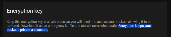

Thanks for this information and can confirm that. It is nowhere mentioned, that the backup gets decrypted while downloading, right.
Is this not super dangerous? If people assume, the backup is encryped and maybe save backups on a public / less secure storage, than they would do otherwise:
Decrypting when downloading from the UI is extremely useful and make reverting small YAML changes a lot easier. This was basically why it was introduced.
