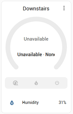

@msp1974 On a three channel hub, it appears that one of the channels is going unavailable after the update to 3.4.4.
Reverting to 3.4.3, brings back nomal operation and availability. Strangely, this is Channel 1, rather than Channel 3.

He has a 3 channel hub. Channel 1 is ‘Downstairs’, channel 2 is “Hot Water” and Channel 3 is “Upstairs”. There are no iTRVs in either room/zone, just a room thermostat in each.
He has one other room called “Kitchen”, which is an Electrical Heat Switch and room thermostat controlling a plinth heater. There are no other rooms related to the central heating though.
Some more information. Demand for all three channels becomes “Unknown”:
I have the diagnostics file. What’s the best way to get this to you? Shall I open an issue on GitHub?
Yes please

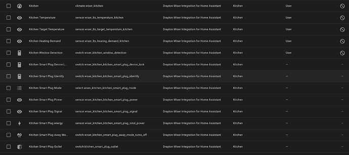

not sure if this is on purpose or just bug, but my Kitchen has no climate controls, only a smart plug, but I get a Climate entity (not unavailable) and a Target Temperature that is unavailable.
I have disabled for now, but it just a heads up.
