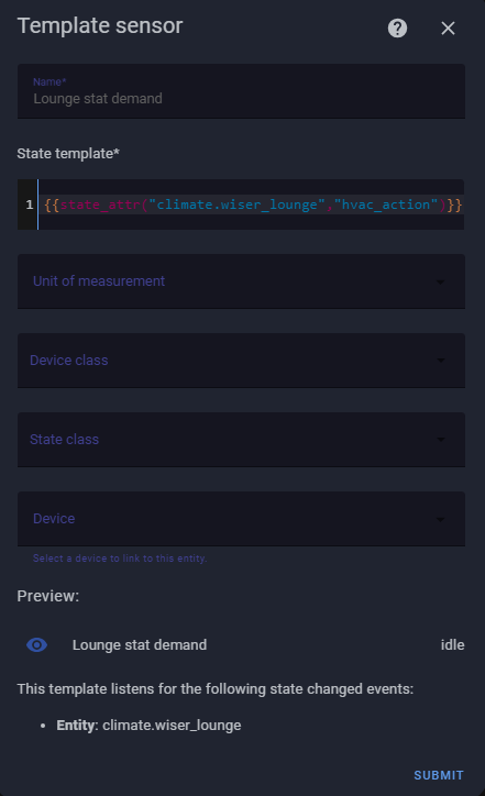

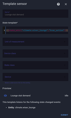

You can set up the template sensor very easily using a helper - go to settings, Devices and services, click the helpers tab, create helper button bottom right, choose “template”, choose “template a sensor”, and fill it in like I have here - I chose the name to “Lounge stat demand”, call them what you like.
Then set up a history_stats helper to track when that has state “heating” (it shows “idle” in my pic), with start and end set as I show in my examples above, and you should get a sensor that gives how long that sensor has been in state “heating”, which resets each day. When setting up a history stats helper, the start and end fields are on the second screen after you click next.
