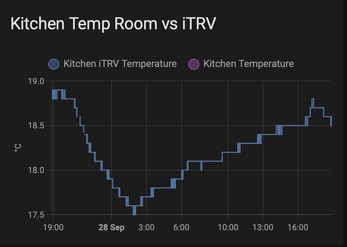

Earlier in this thread there was some discussion about the accuracy of room temperatures for rooms where only iTRVs are measuring the temperature.
I’ve been tracking temperature sensors in iTRVs, Room Stats and a Sonoff Temperature and Humidity sensor I have and noticed the following:
It would be great if we could calibrate the iTRVs manually to account for the measurement difference. Perhaps putting the roomstat in the same room as iTRVs for a week could calibrate them?
Or release a much cheaper interface free version of the roomstat. £75 per room is too much.
Edit: I just moved my Sonoff into the Hallway, so I can compare the measurement by Wiser based on two iTRVs. I will add a graph soon when it has had time to gather the data

I think it would better pass the family test if the figures were more accurate. I can do the mental arithmetic that rooms should be set to 20 degrees if I want 18, but someone is going to read an article about turning the temp down to 17 to save energy and do it…
LOL. Yes, the WAF (Wife Acceptance Factor) is always important. Strangely, I’m actually finding that setting the iTRVs to 19.5 - 20 degrees is plenty warm enough. Based on your measurements that would suggest that they are actually at 18 degrees. I will need to put some separate thermometers in a few rooms and check what the actual temperatures are. I have a couple of Aqara Temperature and Humidity sensors (they can be picked up for under a tenner on AliExpress) kicking around somewhere. I’ll need to dig them out.

Good analysis and pretty accurate apart from the comment on just one iTRV. Let me explain what happens in the different scenarios:
  • iTRV only room: There is a smart algorithm on the iTRV itself with compensation for being near a radiator for a reasonably accurate current temperature. Of course this is an algorithm and the device is next to a heat source so will not always be as accurate as a measurement away from the radiator.
  • Multiple iTRVs in the same room: We take an average across all iTRVs in the room for the current temperature.
  • iTRVs and Room Thermostats in the same room: We use the Room Thermostat for the current temperature because if it is installed per the user manual (at the right hight, away from direct sunlight etc) it will be the most accurate.
The request to allow offsets is a good one and I’ve heard it in the past. It is on our backlog for review but isn’t planned yet. A work around is of course to set the room temperature to slightly higher if you feel the room is always a little too cold.
