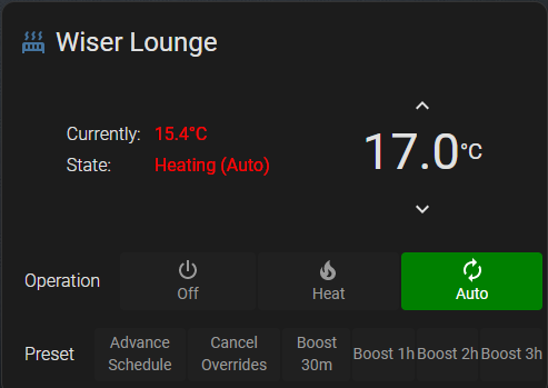

Good idea that, thanks for sharing - makes it nice and clear when a zone is heating
Iâm using the custom simple-thermostat card and have applied the same idea to that
type: custom:simple-thermostat
entity: climate.wiser_lounge
card_mod:
style: |
{% if state_attr(config.entity,'is_heating') %}
.sensor-value {
color: red;
{% endif %}
