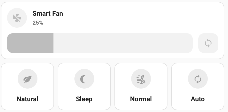

After hours of playing around and writing code with the help of ChatGPT :laughing:
I finally managed to write to make it work just exactly i want.
I managed to put the different modes button below the fan card and also after hours of editing managed to make the colour change as per state of the exact mode on , so that by glacing I know which mode is currently the fan is working on.
Just to my liking.
Few things left is to change the state show the fan speed in numbers like 1,2,3,4 instead of %.
Also trying to find an option set a timer feature like the dreo app
Attaching the screenshot of the card I have created.
Thanks again for making the dreo plugin for HA!

This is great! Can you share the YAML for your card?
Would it be ok if I put it in the README on GitHub for others?

Absolutely, It’s all about sharing in HA community.
I have attached 2 scripts i have made.
1st option - It will show the mode in which it was last on, even when the fan is off. This way, when you turn on the fan, you will know which mode it will turn on to.
2nd Option - the colour for the mode will only show when fan is on mode.
In either you can turn on the fan by clicking the fan name, adjusting the speed or clicking on the mode.
Hope this helps
