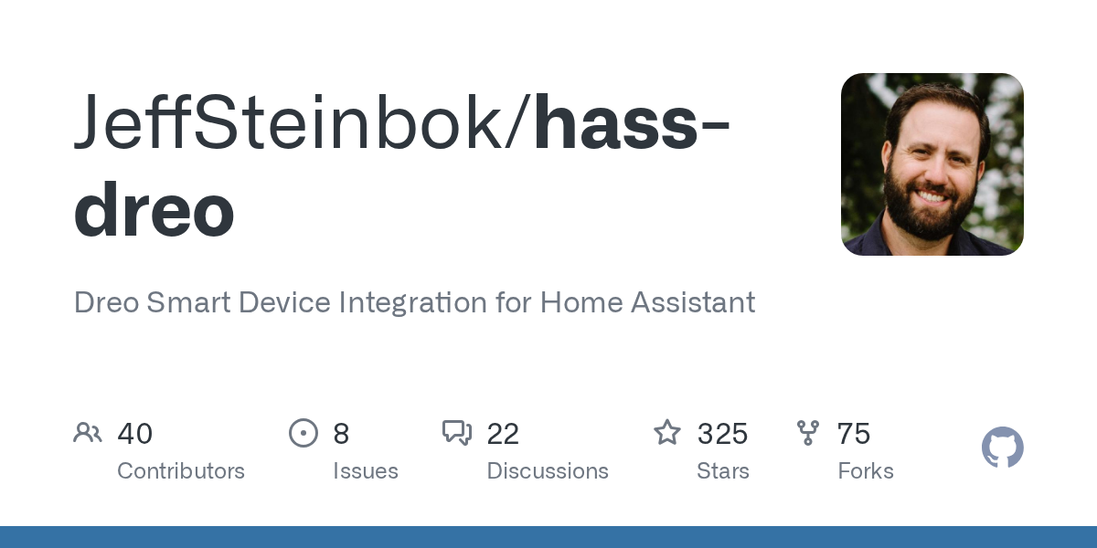

Hey @matech check out this thread on Github. I was able to use the fix that DouewM had. It’s not perfect as you’ll see from, but right now I can get HA to turn on and off my Dreos (I have three in total) and the status is accurately reflected most of the times. The big thing that I noticed is that you cannot change the “Echo” feature from HA, but if changed in the Dreo app, it will be reflected in HA. Also, you cannot change the “Heat Level” in HA, but if changed in the Dreo app, it will be reflected in HA.
Those two thing aside, it works well. And those two things weren’t huge issues for me as the biggest thing I needed was to have an automation tied to a temperature sensor that would turn the units on and off (which is kind of what the Echo mode does) … the built in temperature sensor in the Dreos are so unreliable that the echo feature is kind of useless, so I didn’t mind that I couldn’t control it from HA. And as far as not being able to controll the “Heat Level” from HA, it’s kind of the same thing as the Echo mode for me, as long as HA can turn and off the untis based on the temperature in those rooms, then those two features are not that important.
Hope this helps you some.
@QUemedia Thank you for sharing this information with us. I reviewed the fix provided by DouewM on GitHub, and will probably use it if the Dreo integration is not updated soon.
File an issue on GH and I’ll have a look
