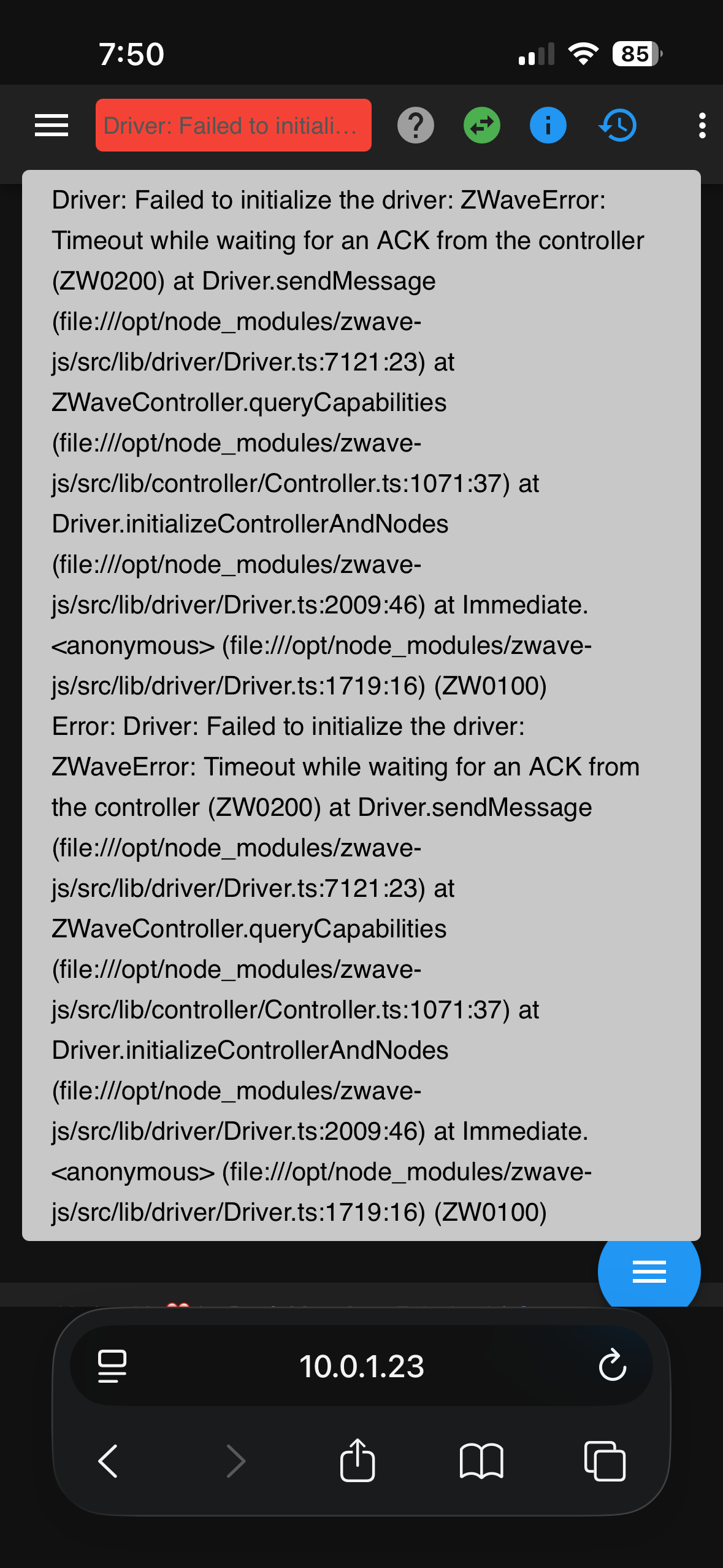

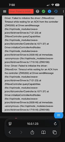

My zwave appears to have failed completely after installing a firmware update last night.
Error message-
Sorry for the screenshot. Evidently copy/paste isn’t supported.
More info-
Google search suggests HA restart or moving the dongle to another USB port. I have tried rebooting several times but I’m at work right now so don’t have physical access to try a different USB port. Reboot didn’t fix the issue.

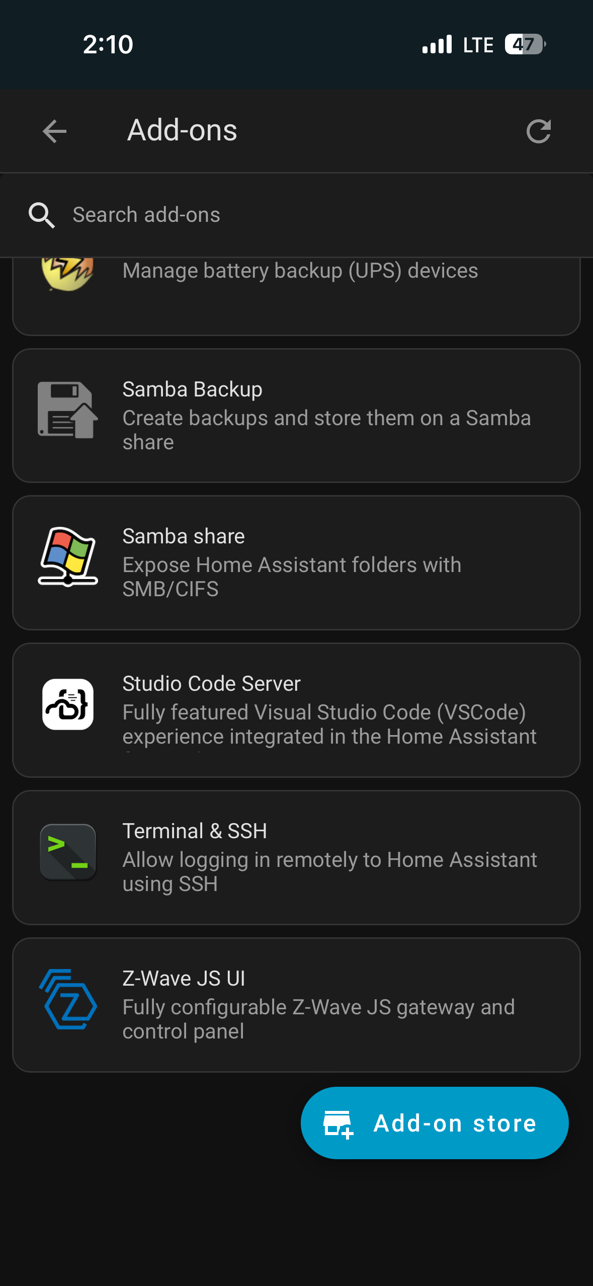

I only have the zwavejs ui integration installed but both addons are installed and running. Is that a problem?
That’s a contradiction. Yes. also sounds like a problem
zwavejsui OR zwavejs. Not Both.
Disable zwavejs. reconfigure zwavejsui. try again
once you get zwavejsui working, remove zwavejs.

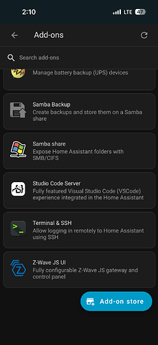

Ok. I installed the zwave addon.
Now I just have the zwave js ui addon-
And the zwave js integration-
Didn’t make any difference with the driver not loading though as you can see in the screenshot above.
uninstalled?
did you configure it?
You need to point it at your zwave stick.

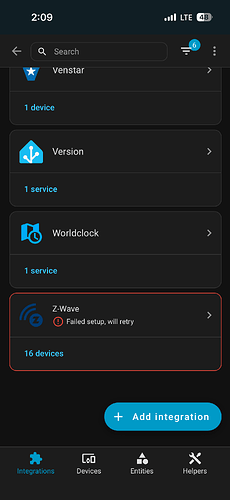

This is not zwavejs integration. it is the zwave integration. You use this to tell HA where to find a zwave hub. In your case, you tell it where to find the server(addon) running zwavejsui or zwavejs with your controller.
INTEGRATION
post the IP/hostname you connected to
ADDON
did you set it up?
if you did and it worked the integration would likely connect without issue
If you did Not or there was a problem, addon will give you an error and integration will not connect(what you currently have)
It’s listed in Settings>Integrations.

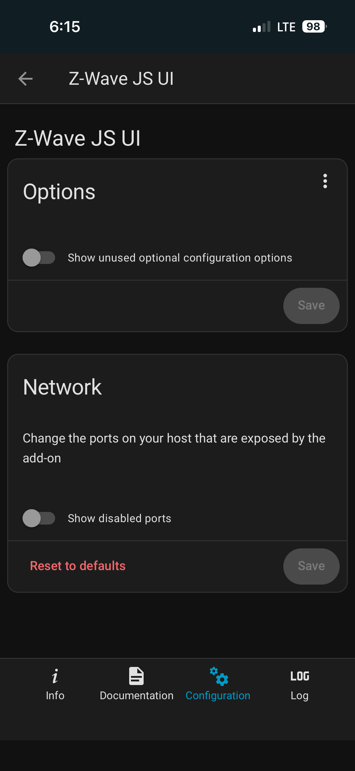

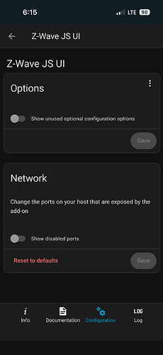

I don’t see anything to configure. This is what’s shown in the configuration tab-
To be clear, this addon was already installed and working prior to the current issue.
