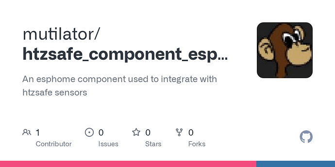

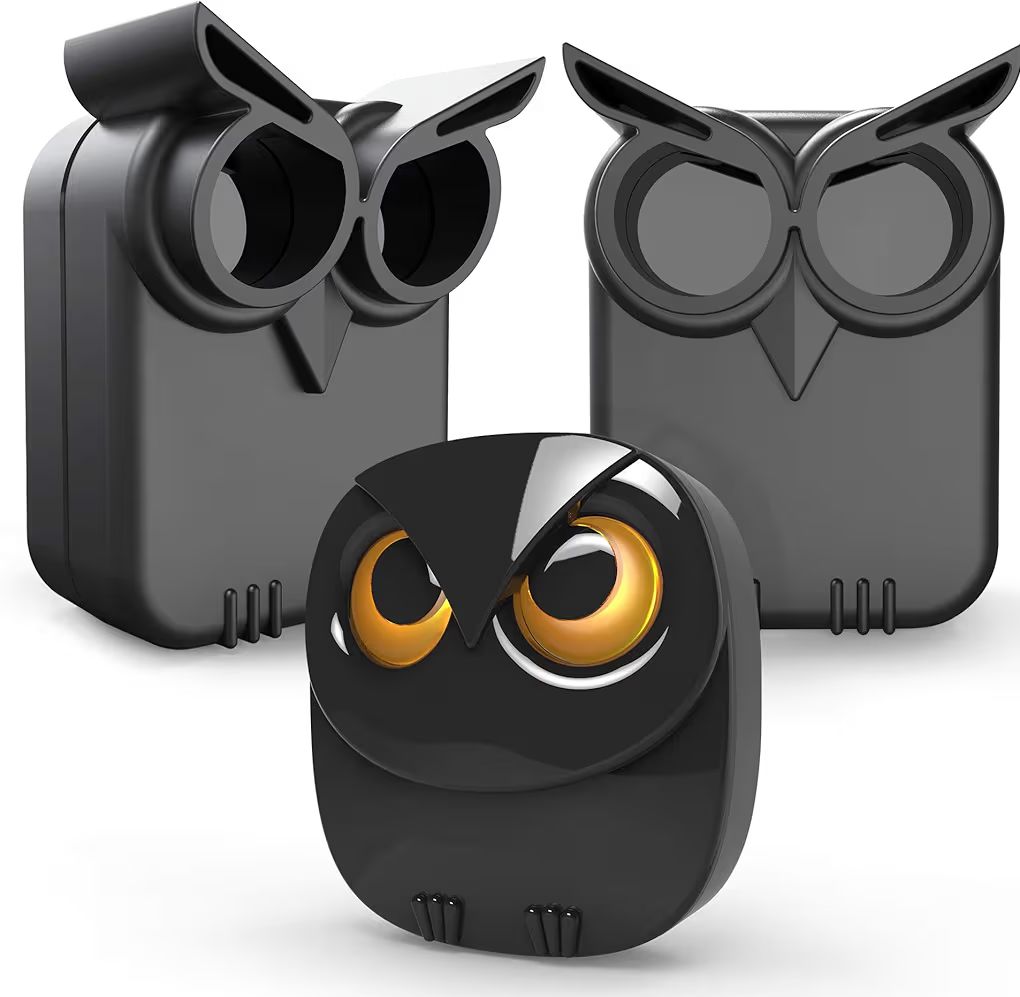

I just bought one of these and made a custom ESPHome component to integrate it into home assistant. After some playing with the receiver I found it outputs the ID of the sensors when they trigger.
Nice! But can you add a photo of your receiver so people know the difference between yours and mine in the OP?

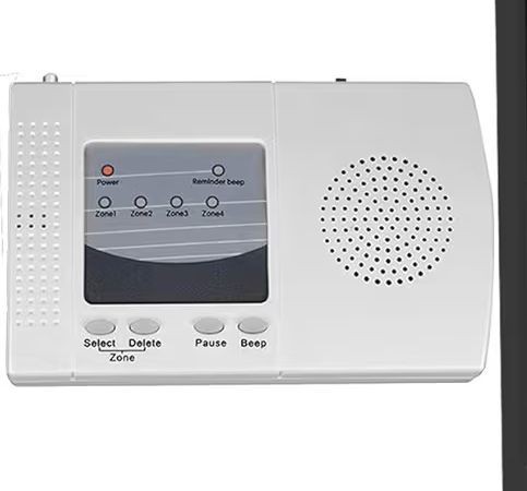

I have two of mine (retro white looking things) in two different residences and for one I am using the zwave relay tied to the output and for the other I have an esp device tied to the output. Both accomplish the same end goal as they are both taking dry inputs from the base unit.
Again, great project, just don’t want people to get confused over the retro white unit I am talking about and your owl unit.

Retro white with accessible outputs:
Owl (see post above for solution):
