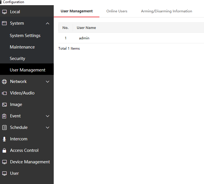

does anyone know how to add extra admin users? seems there is only 1 admin?
in the “'user” section there i can add administratord, but cant provide a password there :slight_smile:
