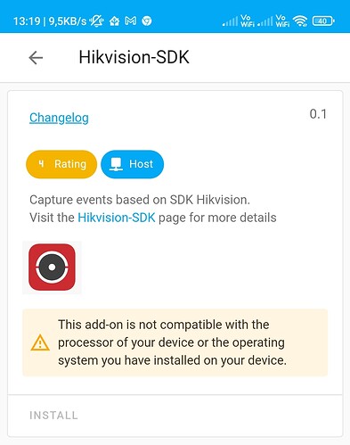

guys, GOOD news for RPI owners, my addon didnt work for you, i have now an SDK LIB for RPI too!!
But i’m unable to test, since i dont own one :slight_smile:
who can test it for me if it works? if yes, i will include it in the addon too, so it works for everyone!!

Guys, updated a NEW addon, remove the old one, and delete/uninstall it, install the new version, seems i had a typo in the folder name :slight_smile:
SO updated, with RPI support (arm) and a lot of new sensors and features
I updated my addon with RPI, test it :slight_smile:
I think you have to state aarch64 in the config.json so that we can install it on an RPI!?
