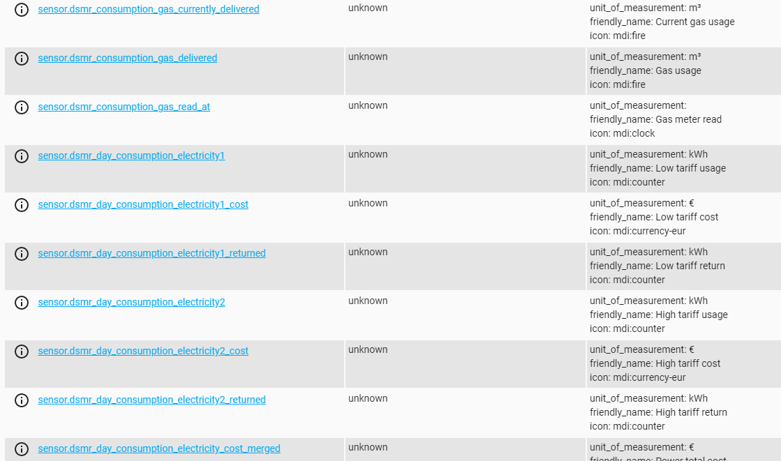

I probably did not configure my DSMR reader correct because I do not get data in HA.
The DSMR reader does send messages (the queue is filled when I reboot my HA / MQTT server.
When it is back online the queue of messages in DSMR is emptied again.

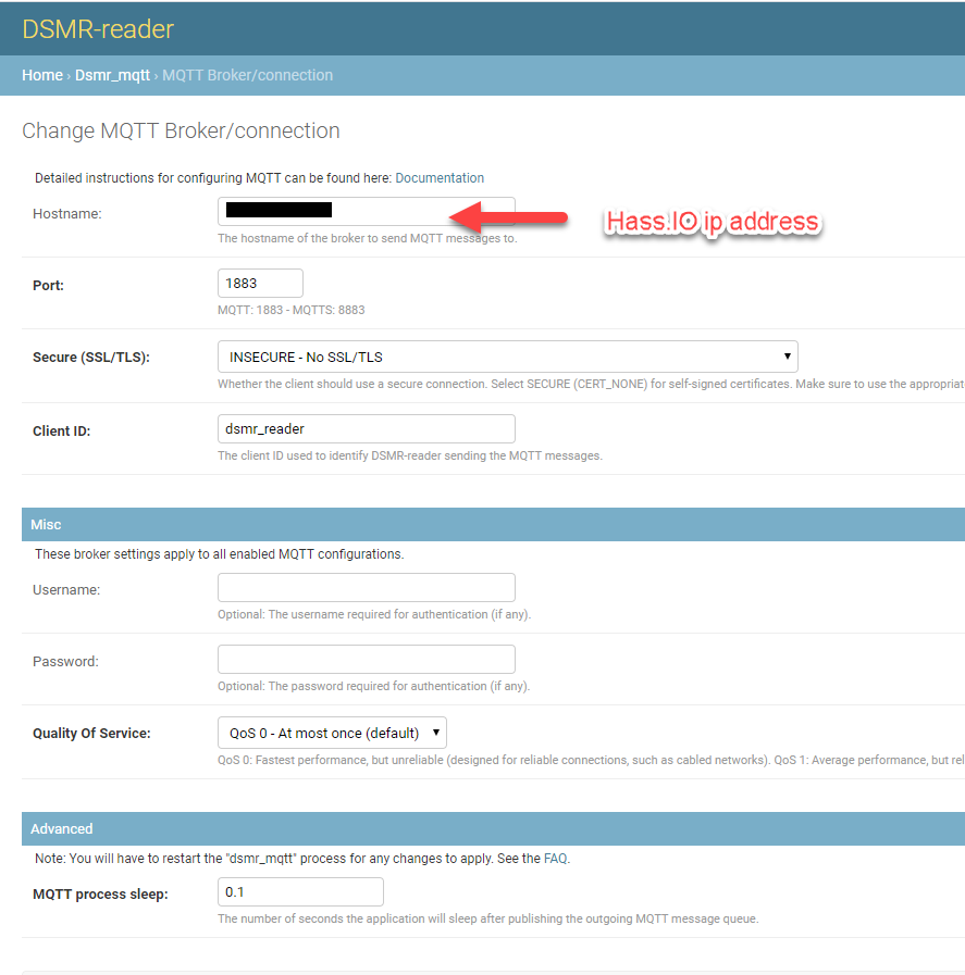

DSMR reader config:
What can be wrong? How can I debug this issue?
