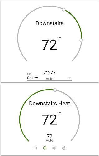

Just found this and its great for my zwave thermostat. Any chance you could put this in the core so its easier for other people to find.
@enriqg9, thanks for your help on this. I was able to make some changes to this that allow 2 new options (min_slider and max_slider). They are optional. But if you put them in, it will set the slider min and max to those values. I have created a pull request for that, if you don’t mind taking a look at it. It’s a non-breaking change so any old configs would continue to work.

When developing this I tried to stay as true to the native card as possible adding just a few key features that I thought the native card lacked.
I think that the min/max values need to stay consistent, otherwise the user experience would be odd when you switch to the Auto mode as you would have a mix of both cool and heat ranges.

@enriqg9, I just updated to 86.1 and the icons for heat/cool/auto are overlapping with the fan control drop down. Is that happening to anyone else after the update?
How does your thermostat render the aux heat mode on the native card?
I think the only supported modes are auto, manual, heat, cool, off, fan_only, eco, dry, and idle.
I don’t have an iphone to reproduce, can you see if this happens in your browser as well? this is likely to be a conflict with CSS.
I’m seeing that issue after going to .86.1, oddly enough I’m seeing the actual temperature and the mode icons pushed down into the fan drop down box to the point that I can’t see/select the modes in Opera and in Chrome on the desktop, however it renders fine in Opera or Chrome on my Android phone.

Like @simpat1zq I see this weird issue and I don’t know if it’s because of 0.86.x but it’s not rendering correctly on any device.
I was able to replicate… this is a CSS issue with the margins will be pushing a commit with a fix
I tried it in firefox on Win 10.
Ok I think this is fixed with the latest commit please check the github repo and comment. HA 0.86 changed to absolute positioning. @simpat1zq @flamingm0e @garn
Should I see icons?
Yes clear your cache or update the script version on your import, your browser might be pulling a cached version
