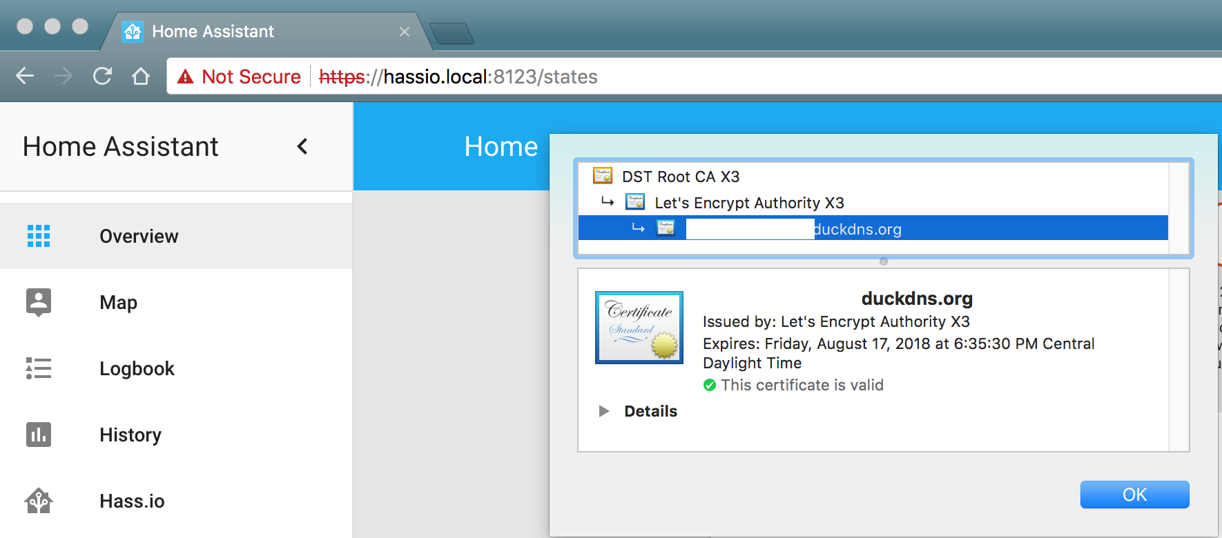

I am able to login locally over https, but receive a notice about an invalid certificate (but I can see the certified cert for mydomain):

Hi everyone. I made quite a bit of progress today and have some good updates to share.
It appears the root of most of my problems was that my router does not support loopback. Most of my testing that I was doing was from inside my network, so I was never able to get to my external IP.

  2. Check local access first for sanity (https://hassio.local:8123 and https://hassio.local - I know, the correct URL at this point should be the first one, but tried both just for fun I guess).
  • DOES NOT WORK. homeassistant frontend never loads all the way.
    See weird log file, note that https://hassio.local:8123 does not work! If I comment
    out the SSL parameters, I can access the local front end over http just fine.

So I definitely think my issue is somewhere along the lines of SSL cert’s and Duck DNS
breaking. I’m beginning to wonder if this issue is related at all:
I may post this topic to the GitHub as well to see if anyone there knows what to do.
base_url: https://mydomain.duckdns.org
should be
base_url: mydomain.duckdns.org:8123
If you want to find
https://mydomain.duckdns.org:8123
on your local WIFI do will need the add-on DNSmasq
should work over a cellular data connection.
Good Luck
