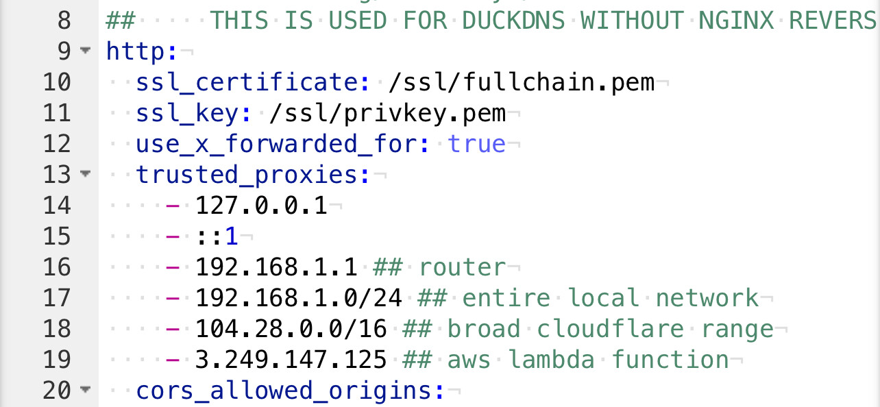

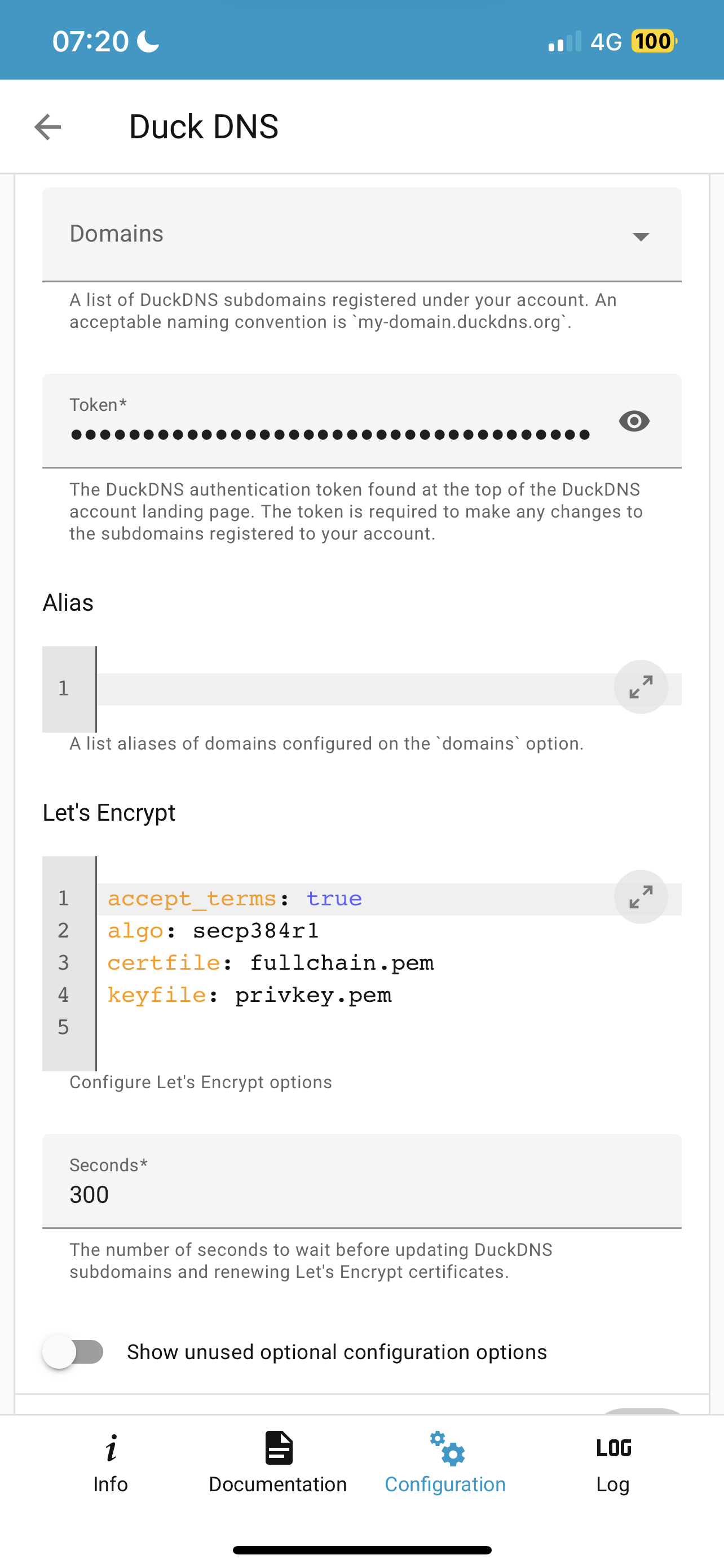

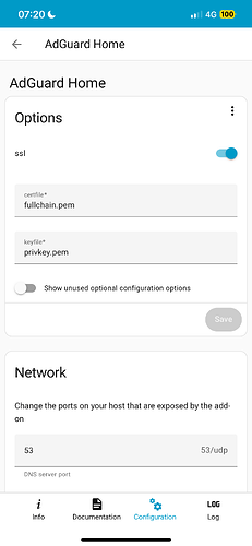

My ambition is to setup an AWS hosted Alexa skill in order to use assist on my Amazon echo devices. I have pretty much got this working, the lambda, the skill account linking. However to get it working I have made a number of settings as follows: Stop NGINX addon, change http configuration yaml, dns rewrite on AdGuard addon to write from external duckdns to internal ip address, port forward on router from 443 to 8123 for Alexa skill and adding loop back to network interfaces for ipv4 in home assistant to make sure AdGuard is primary dns not router for home assistant. As far as I can tell all of these changes are ‘working’. I can access my home assistant instance from the web both locally and remotely using duckdns url.

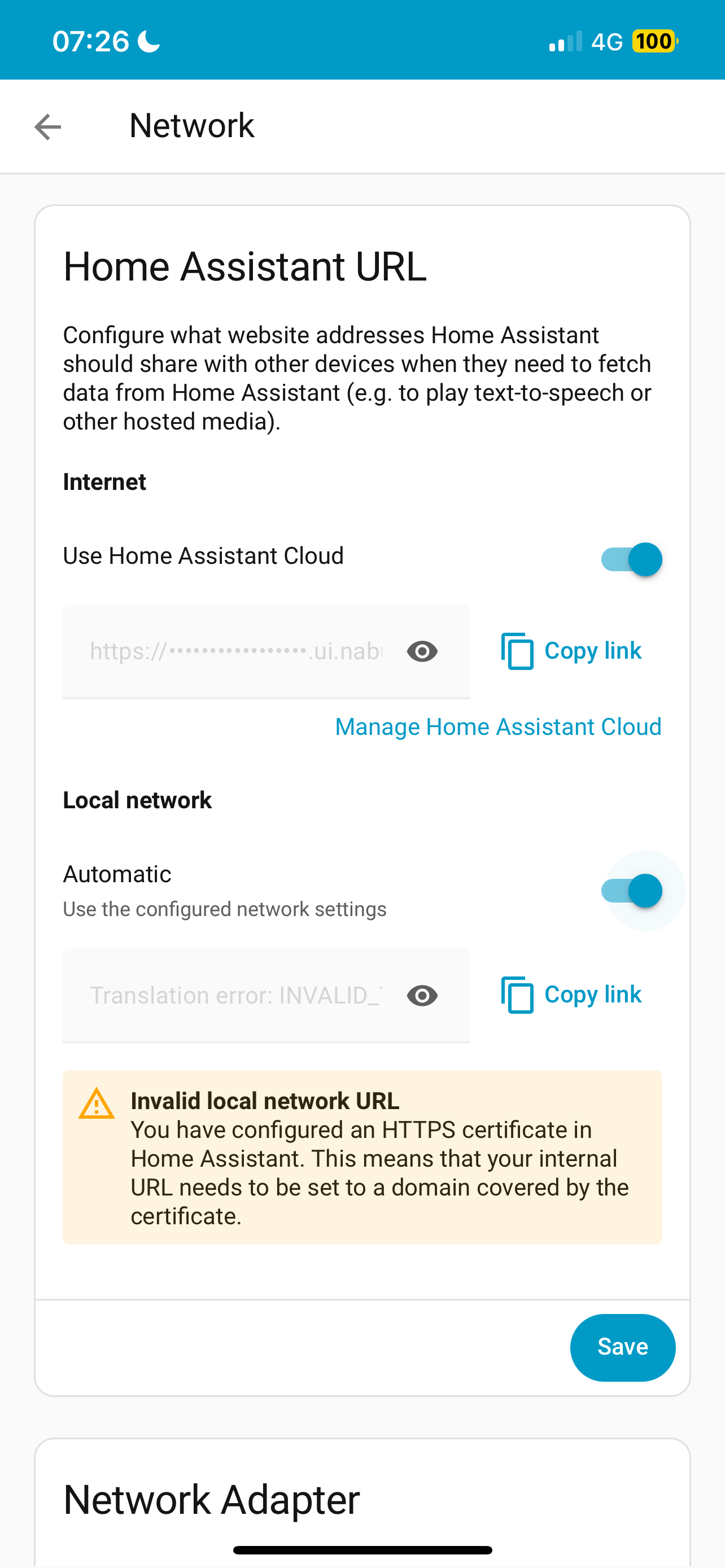

But here’s the question, I cannot get the companion app to accept the same duckdns address for local access as works on mobile web?? I have no idea why. I get 403 forbidden, this does not happen on browser. I’ve tried reinstalling the app.

Never use AdGuard, PiHole, or any other man-in-the-middle-attack DNS Re-directors if you don’t know exactly what it’s doing and monitor it VERY closely.
It is probably the #1 cause of DNS problems in this forum.

The DNS rewrite on AdGuard was really quite a late addition it was in an effort to be able to use the the external duckdns address as the internal url in the iOS companion app. It didn’t help.
