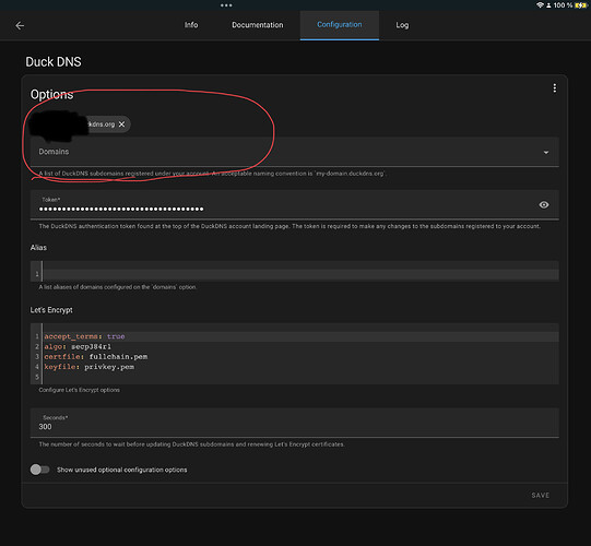

I have installed the addon DuckDNS
  1. I have pasted the token into the correct box and updated the lets encrypt text but when I add the domain registered to my account from DuckDNS I get this error message
I followed the config instructions carefully but I cant see what I missed
Can someone point me in the right direction please, thanks
Have you added your domain in the configurations tab?
It should be the domain you have just created at DuckDNS website, something like: myhomename.duckdns.org.
Thanks for the reply, yes I added my domain in the domain box but when I click save it removes it and show that error message
Try to see in yaml mode and make sure your domain is listed there.

Your new error message is not related to the let’s encrypt part. Note that you have one letsencrypt session inside another one… Try to fix that by having everything in just one.
Take a look on my yaml and you will be able to fix yours easily.
Please let me know if you still having issues.
Ok thanks for your help I’ll persist!
Sorted thanks, I noticed your domain was added and showed above the actual domain box every time I tried to add my domain it just cleared it as soon as I moved from the domain box, anyway changed from edge to Chrome went into YAML mode and it worked
