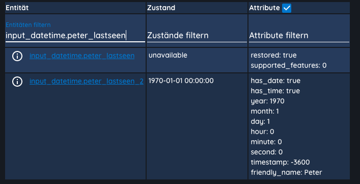

After the update Homeassistant to the newest version I had the following ID’s twice.
They are all:
- timer
- input_select
- input_number
- input_datetime
- counter
- automation
- sensor based on template

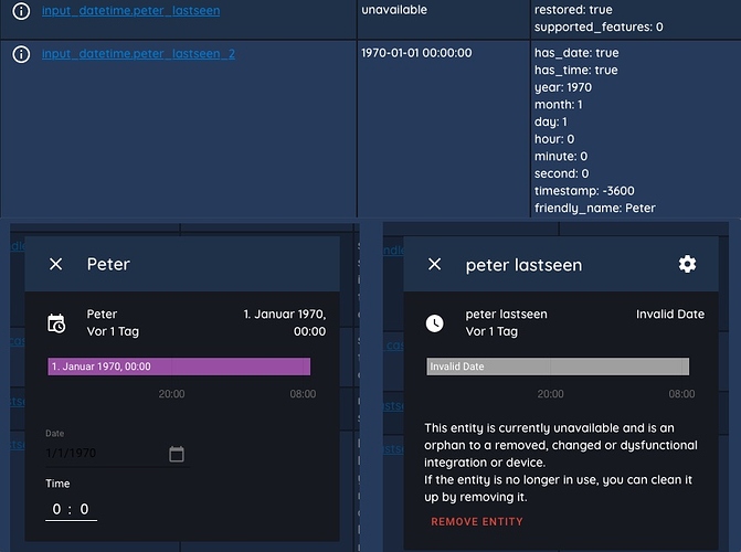

After rollback to version Home Assistant 0.104.3 they are still there. The original IDs all have the attributes:
restored: true
supported_features: 0
Deleting the core.restore_state file and restarting it didn’t change anything.
All of my automations and sensor templates no longer work with the double entries.
How can I delete the duplicate entries with _2 so that the original entries are used again?
