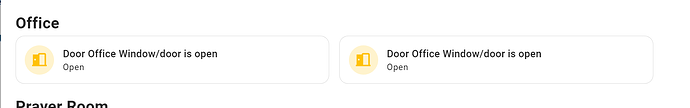

When adding a door/window sensor device using ZwaveJS, I end up with one duplicated entity for the door_window_is_open type entity. For the other entities of the device, there are no duplicates.
I have the MQTT Gateway disabled in the ZwaveJS Control Panel, so the Z-Wave JS UI should be acting only as a Control Panel.
This happens with at least Zooz and Ecolink door sensors. (See Screenshots below)
First:
Second:
This has only started happening since I recently updated both HomeAssistant and ZwaveJS instances. I run both as docker containers Does anyone have any ideas on what is causing this and how to prevent it? I’d appreciate any suggestions.
You can just disable the ones you don’t need. The extra ones are because of the way Z-Wave JS exposes the values to the applications.
It’s not possible to determine whether a device supports “tilt” or “regular” position door status notifications, so it just generates all the possibilities.
@freshcoast Thanks for the explanation. That does make sense. I’ll mark your response as a solution. Unfortunately, I’ll need to rename as well as disable the ones I don’t need.
Otherwise, the numerical suffixes will all be inconsistent with the other entities of that device - the first device would have both binary_sensor.door_window_is_open and binary_sensor.door_window_is_open_2 (even if the second is disabled), and so the second device couldn’t use binary_sensor.door_window_is_open_2 and would end up with binary_sensor.door_window_is_open_3 and binary_sensor.door_window_is_open_4 - while all its other entities such as its battery level and node status will have a _2 suffix.
