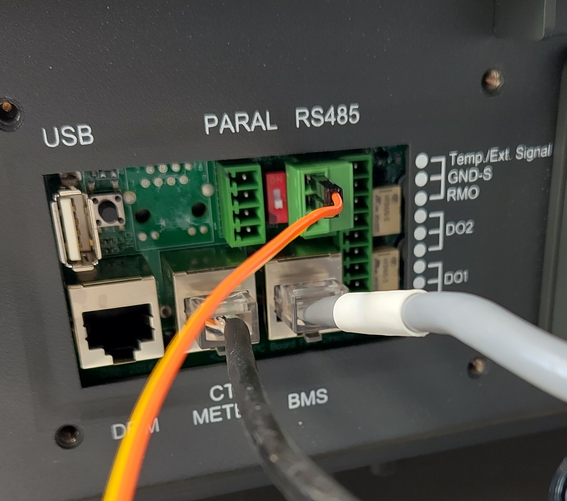

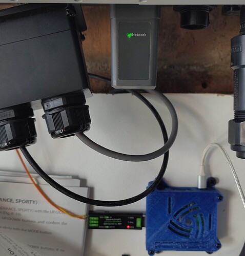

You’ll need a Raspberry Pi (I used a 3A) and a USB to RS485 adapter. I used this one.
You’ll also need the software from https://solar-assistant.io - there’s a free trial. Download the image and install it on an SD card, fire up the Pi and make up a 2-wire cable to your inverter. The RS-485 ports are probably under a cover to the left of the WiFi module:

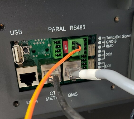

Leave the 120 Ohm termination setting on the USB adapter off, and connect the wires as shown in the pictures - I’ll have to post these separately as my account here is new and it won’t let me post otherwise.
In SolarAssistant, you’ll want to set up the inverter as an Senergy and select the USB adapter

Here’s the other end of the RS485 cable - I need to finish this off and pass it through the gland so I can replace the cover! Sorry it is a bit blurry
Think this isn’t the latest Dura5 inverter as you’ve a four pin rs485 connector.
