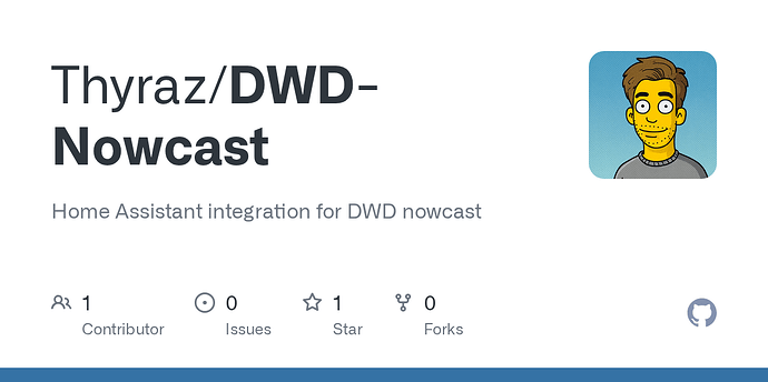

DWD Nowcast (Minute-by-minute precipitation forecast using Deutscher Wetterdienst)
This integration provides a nowcast using DWD OpenData (Radarkomposit RV), which has a compatible response format to the get_minute_forecast action of the OpenWeatherMap integration.
The DWD provides only data for Germany.
DWD Nowcast
DWD nowcast is a Home Assistant custom integration that provides a minute-by-minute precipitation nowcast for a configured location based on Deutscher Wetterdienst (DWD) Open Data.
Follow this link for the license terms of the DWD:
https://opendata.dwd.de/README.txt
What is the difference between a forecast and a nowcast
Forecasts are model-based predictions that try to predict the weather over the next days. They use large weather models to calculate trends such as temperature changes, weather fronts, and development of storms.
Nowcasts focus on the next upcoming minutes (upo to an hour in the case of this integration) and are based on radar images showing the position (and movement over multiple images) of precipitation cells. This makes them more accurate for short-term rain prediction.
If you want to know it will start to rain close to NOW, nowcasts are more reliable.
About this integration
  • Provides a 60-minute precipitation nowcast as a Home Assistant service
  • Source: DWD Open Data radar nowcast (Radarkomposit RV)
  • DWD Update interval: every 5 minutes
  • Time resolution: 5 minutes, internally interpolated to per minute values by the integration
  • DWD Forecast resolution: approximately 1 km grid
  • Location mapping: Configured latitude/longitude is mapped to the nearest grid cell

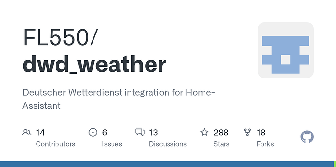

This integration focuses on minute-by-minute precipitation ONLY. It does not
expose standard weather conditions, temperature, or long-term forecasts. For full
weather data from DWD, use this dedicated DWD weather integration:
HACS installation
  1. In HACS, go to Integrations.
  2. Open the menu (top right) and choose Custom repositories.
  3. Add this repository URL and select Integration as category.
  4. Install DWD nowcast.
  5. Restart Home Assistant.
  6. Add the integration via Settings > Devices & Services.
Manual installation
  1. Copy the custom_components/dwd_nowcast directory into your Home Assistant
    custom_components directory.
  2. Restart Home Assistant.
  3. Add the DWD nowcast integration in Settings > Devices & Services.

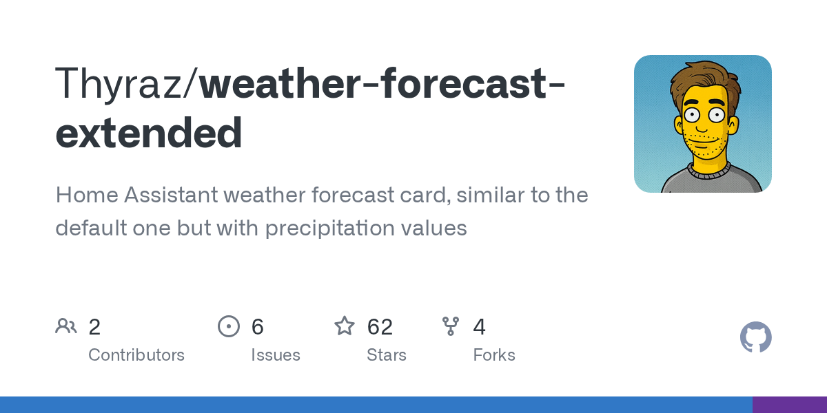

My weather card now also supports displaying nowcasts:

There is no repo url. you could use a my-link (blue button) for it.
Ah well, adding the long would have been a great idea, right? :smile:
Added it in the top post.
Currently not at home, have to investigate if my-links work when the repo has to be added manually to HACS.
Ok, tried to add a my-link button above.
Hope it works. :slightly_smiling_face:

My weather card now also supports displaying nowcasts like the one from this integration:
it would be nice to have an example diagram. F.e. using mini-graph-card.
To be honest I have no idea which charting carts support data from action calls instead of history.
I only use it with the custom weather card linked above, which is where I created it for as a drop-in replacement for the already OpenWeatherMap action.

There is already a different DWD weather integration for HA to get the standard weahter forecast.
