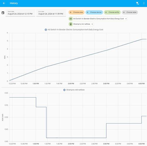

Yes, it works perfectly. This is from my water heater, using 3 kW until 4 PM today. Great work, @arva!
As I am not a programmer this took some testing to put together correctly. :smile: I hope it may be useful for others. The variable price of power in Norway (per kWh) is made up of two parts, the energy itself and for use of the grid. The energy price change every hour, the grid use has a low and a high price, depending of time of day and if it is a workday or not. The energy price is simple - i get that from an integration (Tibber or Nordpool). The grid part I have to add myself, and this Template sensor does the job for me, with two helpers “input number” to make it possible to change the price when updated without editing yaml code. Finally I use a helper that sums the two parts, and that is what i use in Dynamic Energy Cost.

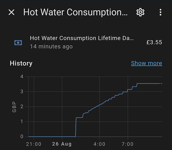

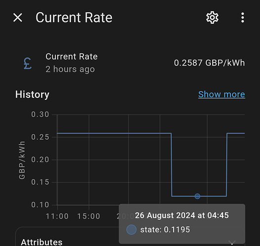

Hi, I set the integration up yesterday to run overnight and I’ve got a result that doesn’t like up with what I had expected. It must be a configuration issue on my part as the produced cost graph follows the same curve as the kWh consumed graph:
The cost output for last night’s usage is many times higher than what it should be. The kWh usage was 5.27kWh at a rate of £0.1195/kWh (£0.6297).
Any ideas where the £3.55 figure has come from? It would suggest a unit rate of £0.6736/kWh (with 5.27kWh) or 29.7kWh consumed at £0.1195/kWh.
I thought it may have used the day rate initially but that doesn’t math right either.
I have used the sensors in the images above in the configuration for the integration.
Update
Clearly I made some configuration error initially. I went through and deleted the original entities and reconfigured the integration using a kWh sensor. The new entities populated with the existing bad data but last night the daily sensor reset and now shows a much more sensible number of £0.32 kWh usage. I will manually reset the weekly, monthly and yearly entities and start fresh.

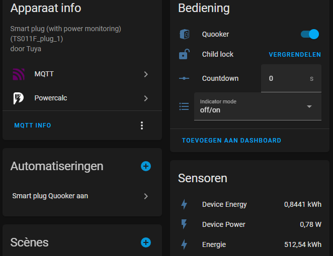

I installed this addon recently and added my devices and linked them to my P1 meter, which are filled in with day and night rates via the Energy tab.
Most of the devices do not have much correct prices because then the electricity would be very expensive.
I am slowly switching from Homey to Home assistant and in Homey there is an app called “Power by the hour” that I use.
When I compare the data from Dynamic Energy with Power by the hour in Homey I see big differences and I know that the app works well when I compare it again with what I see in my Homewizard P! meter software.
My P1 meter automatically changes to rate 1 and 2 at 23:00 and 07:00.
I have also tried it with a utility meter that set the two rates via an automation at the correct time, but in both cases the result is the same and incorrect.
Attached are some pictures to make things clearer.
What am I doing wrong?
This is how I have it set up and have tried both options. Which one is correct?
