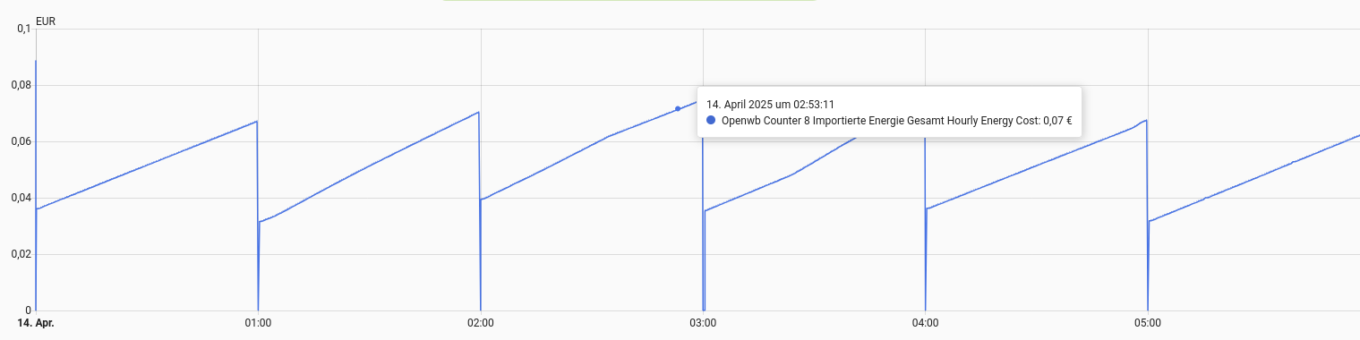

Hi everyone, I’ve been looking for a functionality like this for quite a while. Great work you did! I got it to work some time ago, added an energy meter and the my hourly price and everything worked like a charm!
Recently I allowed somebody to charge their EV at my house. They asked me for the price and I thought: ā€œgreat possibility to use the dynamic energy cost pluginā€. By looking at the values and doing a quick calculation I realized the cost calculation is not correct for me. I did a spreadsheet calculation for today and can now see, that the values of the plugin are consistently higher than the spreadsheet data.
Can anyone help me to look at the values in the variables that are used by the Dynamic Energy Cost plugin?
Thank you very much!
Matthias
Hello alltogether, looking at the variable (…hourly_energy_cost) I found some odd behaviour: The value rises during each hour, is being reset to zero at the full hour. but the next second it jumps up to around 4ct. and increases then steadily towards the end of the hour.
Is anyone else experiencing the same? Who can point me to the area in the code, where the reset is taking place?
Cheers Matthias
