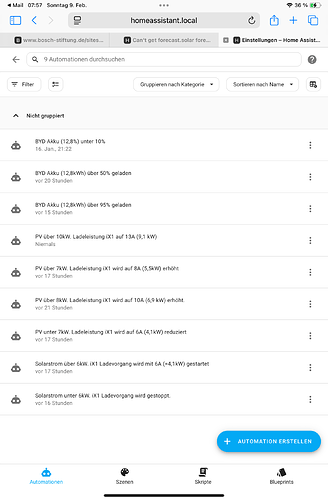

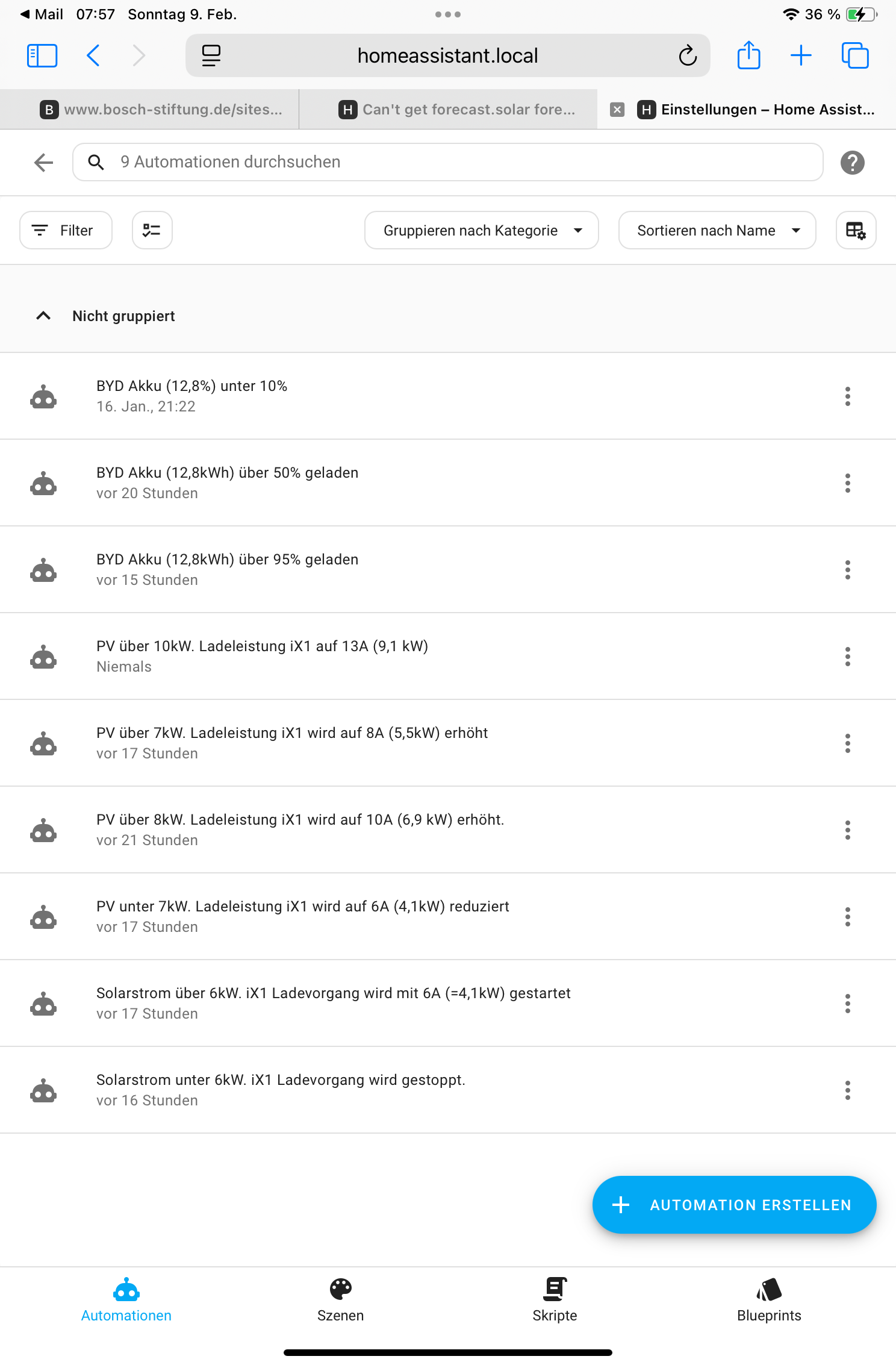

I also want to join the discussion. Unfortunately I cannot help, because I am also an absolute Home Assistant beginner. I also have an BMW (Model iX1) and I don’t have a Wallbox but only the BMW Flexible Fast Charger which has no ethernet / wifi connection. So the only way to start/stop and define the AC Limit of the charging process is possible via the MyBMW App.
But there is an Home Assistant integration for BMW Assist which makes it possible to start/stop the charging process and define the AC limit.
I have solar panels on my roof and I want to start the charging if there is an energy surplus in my house. Has anybody already implemented this?
@Drossi : I think there is a minimum of 6A to begin the charging Process… when I try to limit this I can step down from 32A to 6A but not below…
Any help would be appreciated…
Indeed. The min charging is 6A. Below 6A is off. I was not able yet to find the solution but keep trying…
And if your BMW only supports 11kW the values over 16A also don’t have no impact to the charging process. So if you choose 16A or 32A for your 11kW car it won’t change the power input for your car and this is only relevant if your car supports 22kw AC.
I don’t have a smart Wallbox but only the flexible charger. But with the BMW integration and automations you can build a process that charging starts / stops and the power increases / decreases depending on the solar power …
